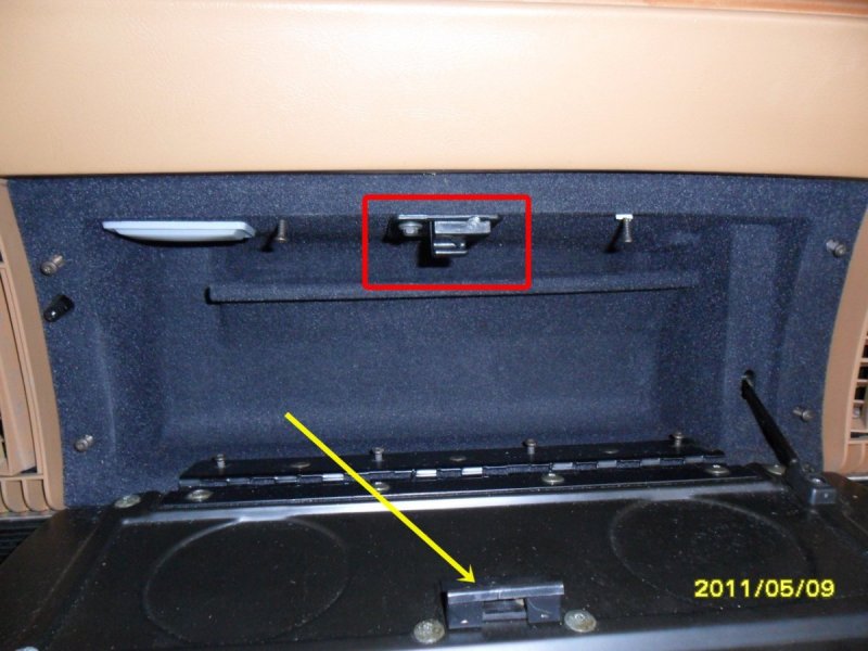

Ronnie Posted June 27, 2021 Share Posted June 27, 2021 I looked and didn't find it Woody. Maybe some of the photo below will help but they are from my '88 which is different. I hope it helps. You can see all the screws have been partially removed that will have to come out. the second photo shows the BCM behind the glove box. Link to comment Share on other sites More sharing options...

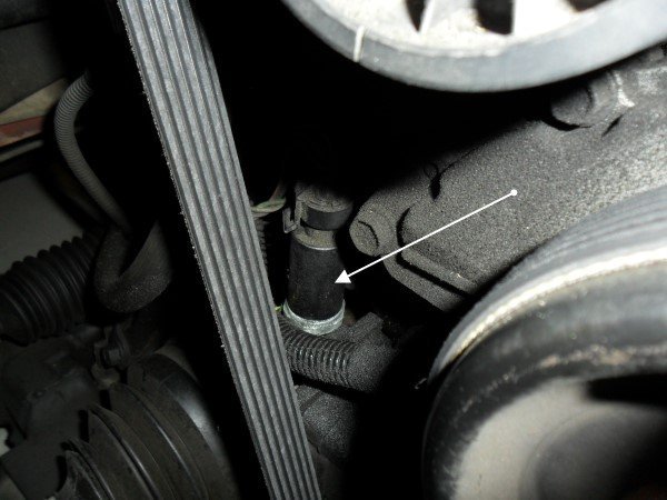

Ronnie Posted July 7, 2021 Share Posted July 7, 2021 Woody, Here is a photo of the location of the oil pressure sender we discussed on the phone. Link to comment Share on other sites More sharing options...
Padgett Posted July 7, 2021 Share Posted July 7, 2021 I've replaced one on a curb before. This one looks OK. GM are so notorious for going bad that I always just kept an extra in stock. BTW this is for early 3800s, After 91 they used a different one. 1 Link to comment Share on other sites More sharing options...
Ronnie Posted July 7, 2021 Share Posted July 7, 2021 I replaced the oil pressure sender on mine with a pair of channel locks many years ago by bending over the fender. I did remove the belt to make it easier to get at the sender. Link to comment Share on other sites More sharing options...
DAVES89 Posted July 7, 2021 Share Posted July 7, 2021 I used a vice grips using the new one to set the jaw size on the vice grips. Worked well. Link to comment Share on other sites More sharing options...
Padgett Posted July 7, 2021 Share Posted July 7, 2021 88 is easy, when was the brace added ? Link to comment Share on other sites More sharing options...

MarkN Posted July 12, 2021 Share Posted July 12, 2021 Interesting…I had to replace the oil pressure sender on my ‘91 and it is oriented horizontally, not vertically as shown in the photo above. (Why would GM change something so simple?) Link to comment Share on other sites More sharing options...
