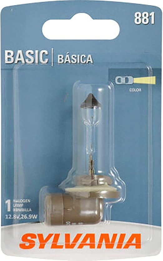

The chart could be wrong. I made it. The difference is the 880 bulb has a straight electrical connection and the 881 has a 90 degree connector. I have 881 bulbs in my Reatta. Which is the correct bulb?
SYLVANIA - 881 Basic - Halogen Light Bulb for Fog, Cornering, and Daytime Running Lights (Contains 1 Bulb)

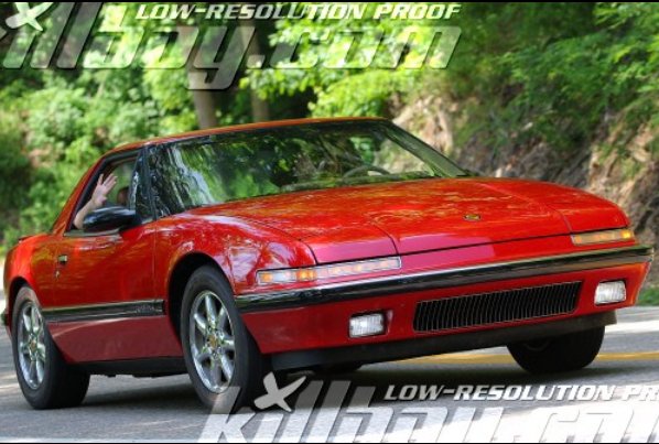

My Reatta had 881 bulbs in it when I got it. I have since installed 881 LEDs. Now I'm wondering which is the correct factory bulb. the 880 or the 881?
I put in the LEDs because they are brighter and get more attention from other drivers as I use them for daytime running lights. You can see how bright they are in this photo.
The FSM lists the 881 as the correct bulb for the Fog Lights.

I believe the 90* type connection is correct, but beyond that, the specs are the same. I too use led's in the fogs, license plate, all interior courtesy, backup and underhood/trunk lights. The fog lights are glorified marker lights IMHO, and the switch to led's makes them more noticeable during the day. I do wish the other almost 30 bulbs didn't also illuminate when used as DRL's but I never looked into defeating that circumstance.
Think the only difference between a 880 and an 881 is the angle of the plug. Would be a minor rewire to transition the fogs from "with taillights" to "alone with ignition"
