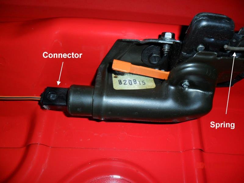

Ronnie Posted December 25, 2020 Share Posted December 25, 2020 There are a fuse (body fuse #7) and a circuit breaker that powers the trunk release solenoid. If your power door locks that circuit breaker is good. There is also a trunk lock relay in that circuit but I don't know where it is located. As ship said, there is a manual release on the latch. It is the orange bar shown in the photo. Link to comment Share on other sites More sharing options...
