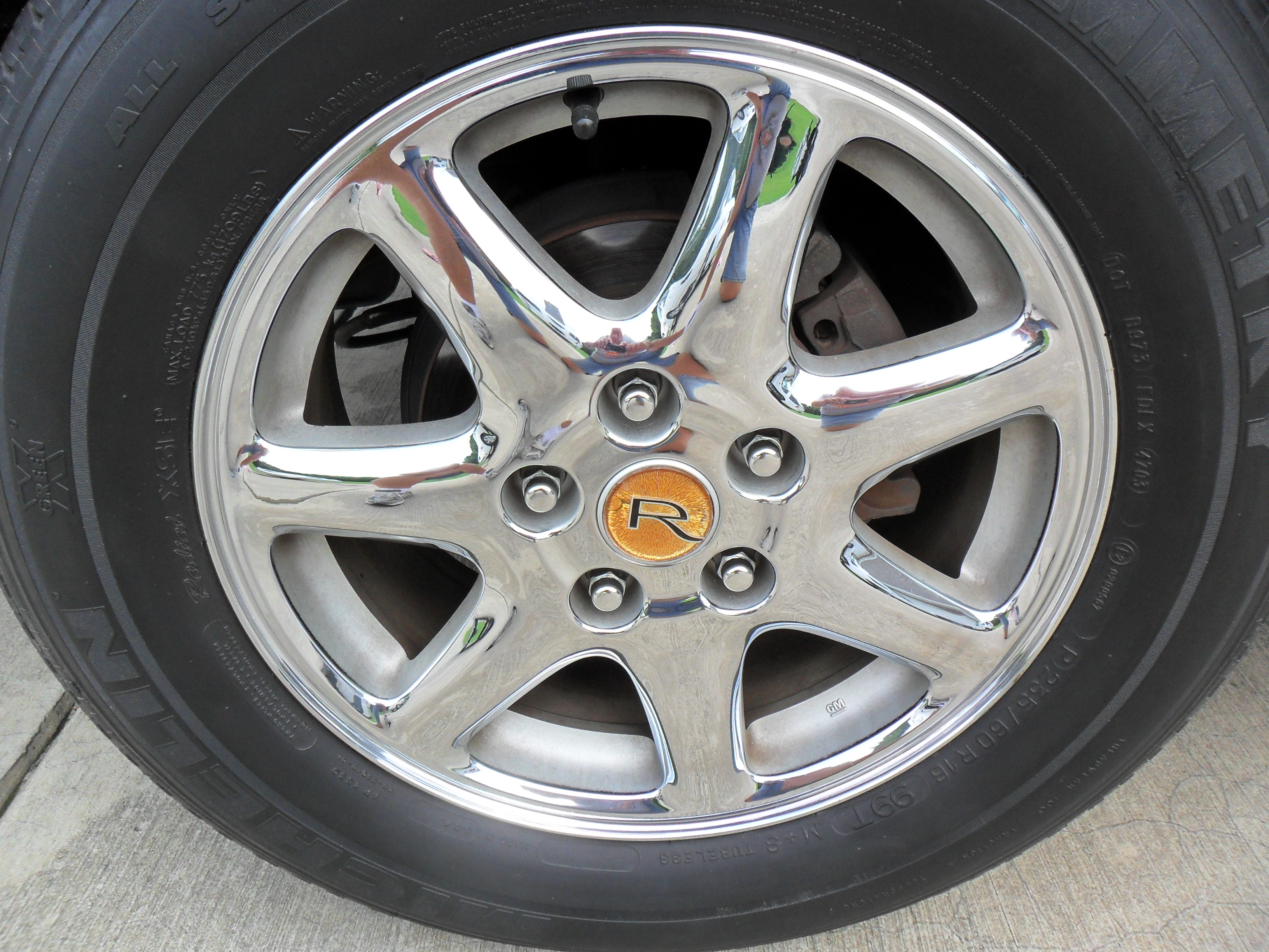

Here is a photo of my chrome wheels that cost a third of what you quoted and they had good used tires on them.

Take a hard look at the wheels in Ronnie's picture. They are Buick LeSabre wheels and are made of aluminum alloy with great chrome on them to give you years of great service. They are cheap and are 16" and will make the wheel well look better.
I like them so much they are on the Red and the 'vert.
The Black has the stock Reatta wheels as the Black is my winter daily driver.
Here is a close up shot of the LeSabre wheel that I have on my car. As Dave said, they have really good chrome on them. Don't count on finding those Reatta center caps in a salvage yard. :P

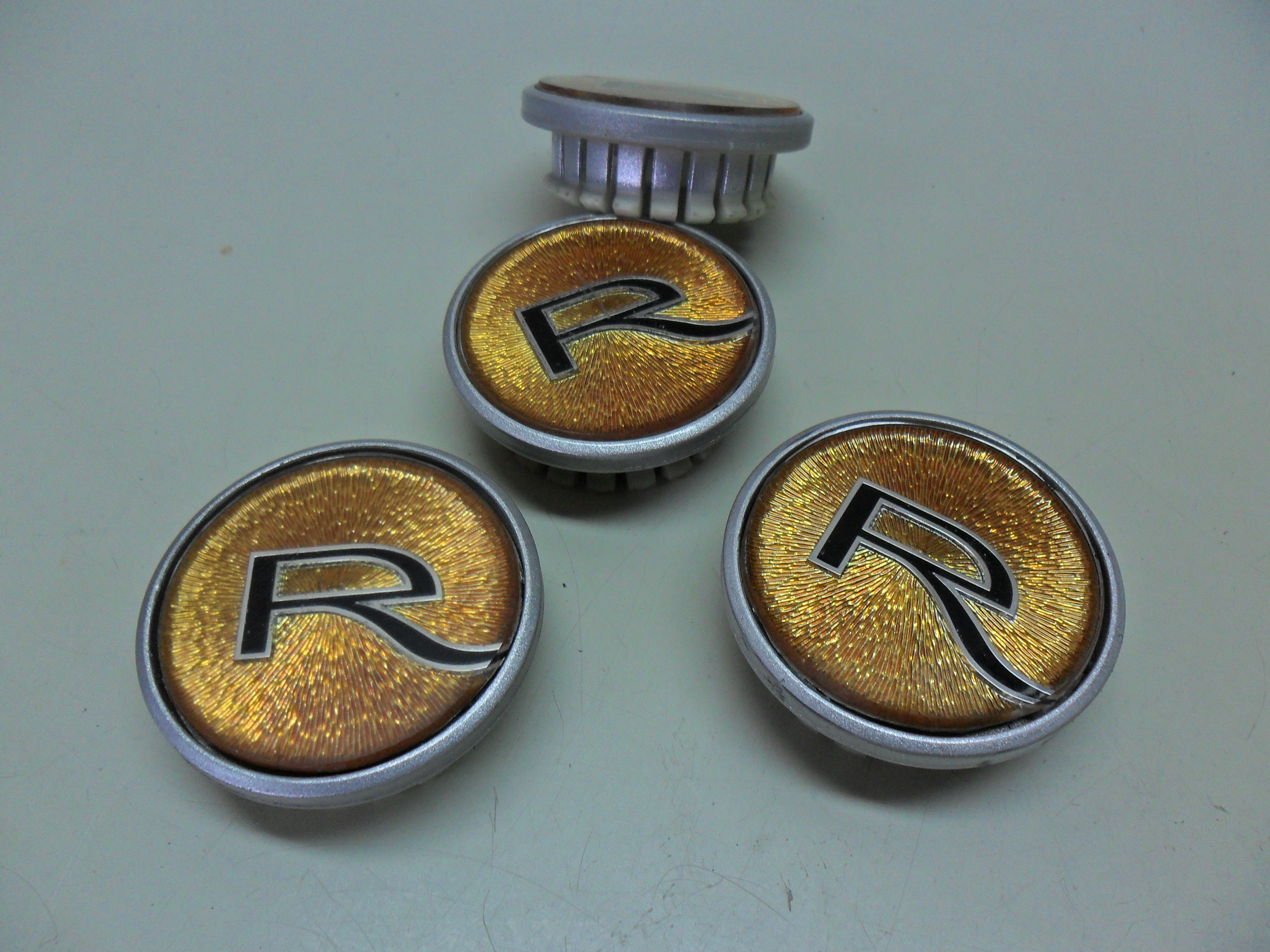

OK Ronnie, so what gives on the center caps.  I have found a great set of chromes for my '89, but need those lovely center caps!

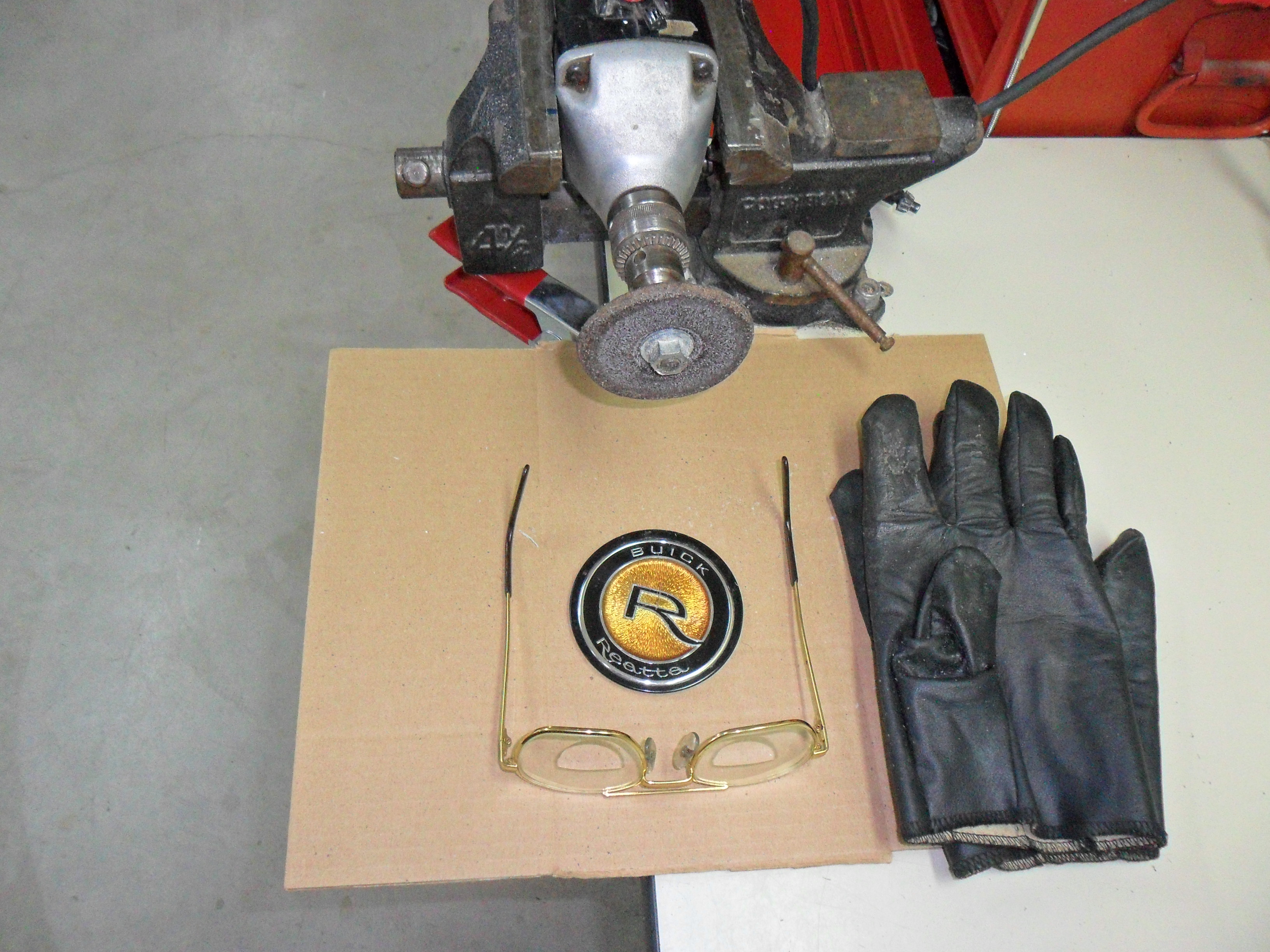

The center caps in my wheels are custom and aren't available anywhere. I had an extra set of stock center caps that I removed the emblems from. I carefully ground them down to fit the centers that came with my wheels.
I've got a bench grinder but I found an abrasive grinding wheel mounted in a variable speed drill running at slow speed worked best.
You have to be careful not to scratch the silver on the back of the emblems. If you do it will show through on the gold color on the front side of the emblem.
