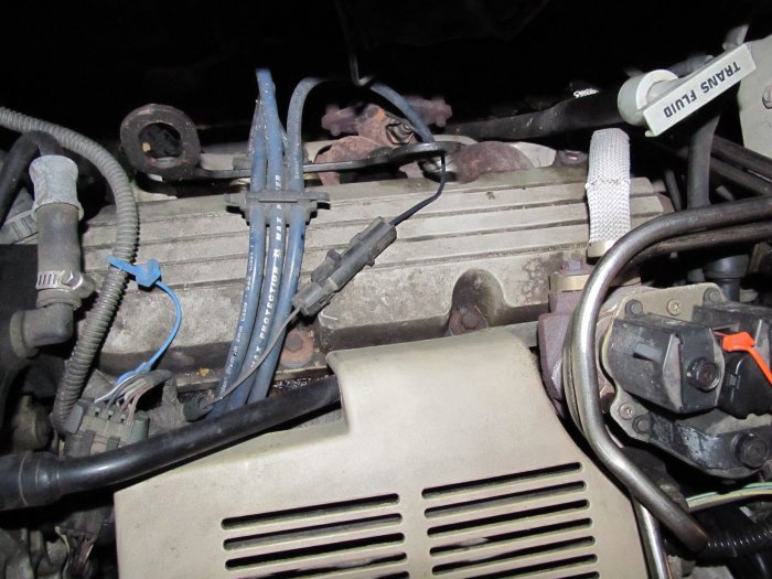

Ronnie Posted December 18, 2016 Share Posted December 18, 2016 This may be a little late but I stumbled across this photo that might help understand what holds the injector cover on. The clips that are circled, snap onto the u shaped fuel rail pipe. Pull on the cover near the clips, starting on the back side, leaving the one near the schrader valve for last so you can gently work the cover out from under the metal tubing that goes across the edge of the cover. I've had mine off many times. You just have to remove it carefully to prevent breaking it. Link to comment Share on other sites More sharing options...
