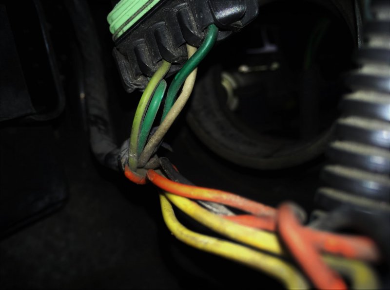

1.  Disconnected “orange” set of wires connected to Headlight Door Module.  Turned key to “on” position without starting the engine.  Both the “orange square” indicator light on the headlight switch and the “Lights On” remained on.   Turned key back to off position.
2.  Disconnected “green” set of wires connected to Headlight Door Module.  Turned key to “on” position without starting the engine.  Both the “orange square” indicator light on the headlight switch and the “Lights On” remained on.  Turned key back to off position.

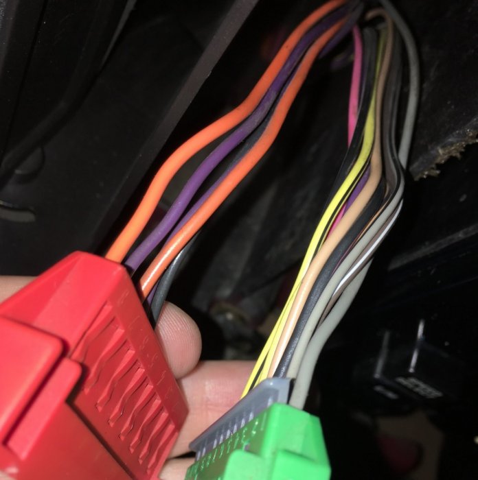

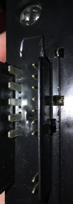

5.  Removed dash panel and disconnected both the red and green plastic connectors to the headlight switch assembly.  Then turned key to “on” position without starting engine and the “Lights On” light on the digital display was gone (I think) because then screen quickly went to “Error 00” and nothing more.

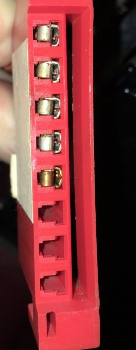

7.  When I connected only the red side (with five wires) the small orange light on the assembly would come on.  But the “Lights On” would not illuminate on the digital display.
8.  When I connected only the green side (with the 12 wires) the small orange light would not illuminate and the “Lights On” would also not illuminate on the digital display.
9.  When I connected both the red and green connectors the “Lights On” would also display on the digital instrument panel.  (But this happened quickly before the “error” display)

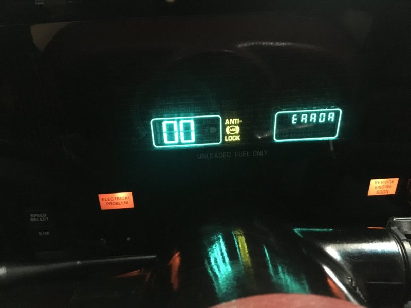

10. After I tried replicating this with several tests the digital display would only show the “00 Error” screen and nothing about the lights, as a normal "full" display would show.

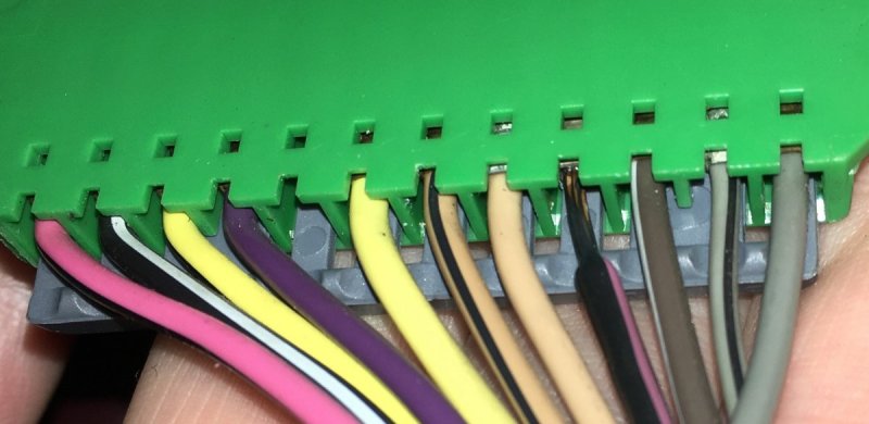

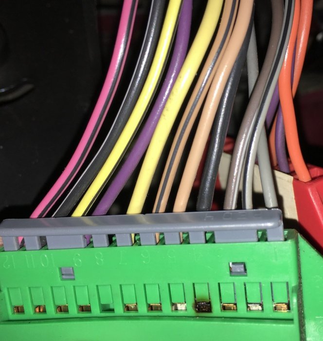

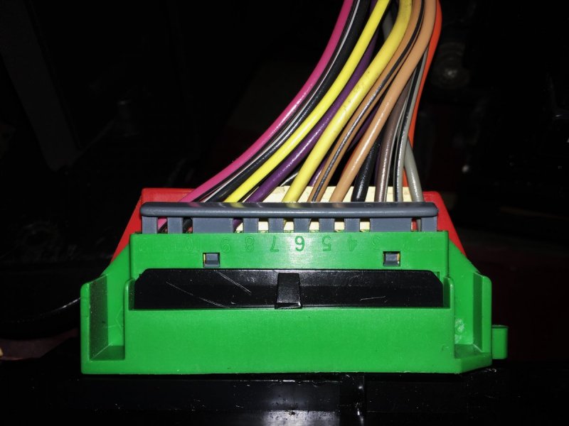

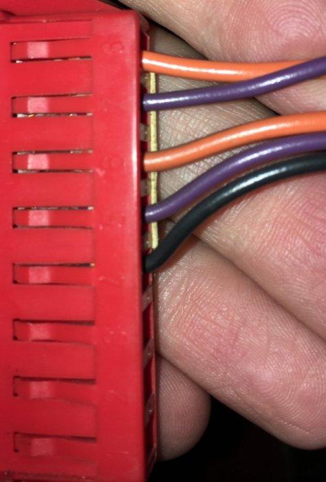

11.  Looks like the fourth “burned pin” on the green connector is predominately black in color with a thin purple strip.  You can also see how it is thinner at the base than the other wires.

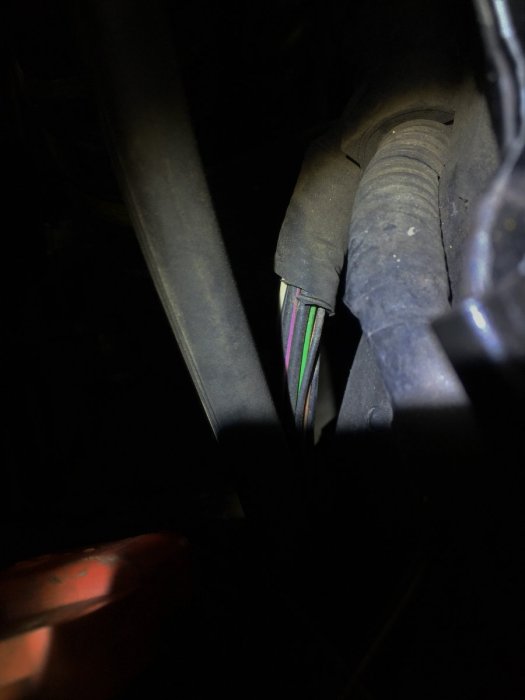

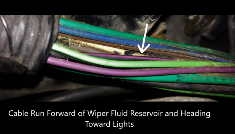

12.  Visually looked in the engine compartment for similar wiring.  Neither the “green” nor the “orange” wire bundles going into the Headlight Door Module have a similar black/purple wire.  I did find a similar black/purple wire (but much larger) going into the Engine Relay Center Box and also in the vicinity of the right headlight (photos attached).
13.  I am confident that the only time the small orange square illuminates is when I attach the red connector (with the five wires) to the headlight switch assembly (even without inserting the key).

15.  I could not get the dash to illuminate fully (only the “error screen”) when I tried turning key on subsequent tests with both the green and red connectors attached.  (photo below)

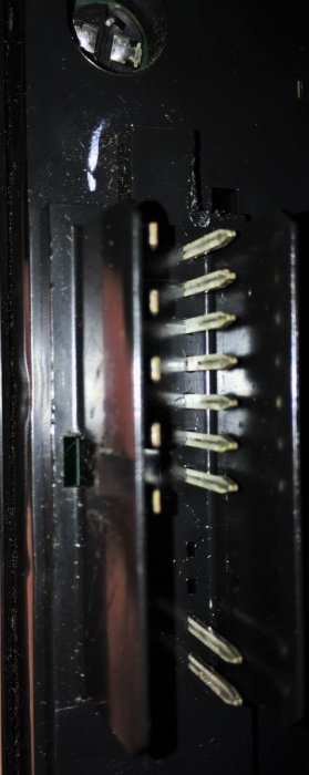

Something about the number 4 spot in the connector isn't right. Not sure what is going on. Looks like the small part on the end is either been really hot exposing the copper causing it to look black from heat or melted insulation. What is so odd about that is that the way the insulation stops is so uniform and from there on back it doesn't appear to have been hot.  When I blow up the photo and look closely at where the wire goes into the terminal it looks like there is solder on there. Since you said you have owned this car for years that probably isn't the case. Have you ever had anyone work on the headlights before? At any rate that terminal 4 in the connector needs to be fixed from what I can tell by looking at all your photos.

Have you tried removing that discolored connector? I don’t know if it is push or pull type of install ?

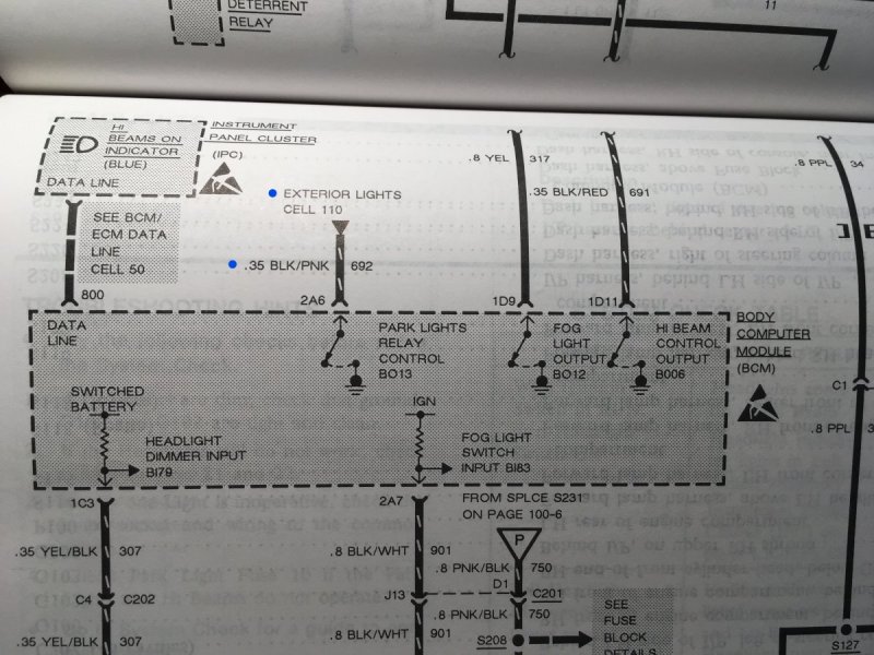

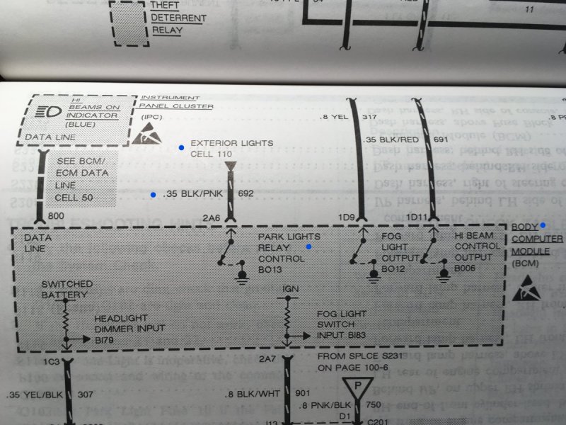

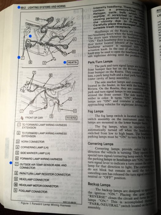

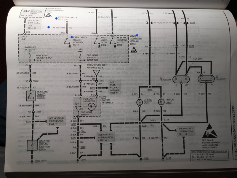

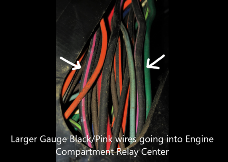

1.  Found two references to a black/pink wire in the 1990 Service Manual.  Have included a few pictures below mentioning this color wire.  (My working assumption is that the first color listed is the predominant color and the second listed is the smaller “stripe.”  Please let me know if this is not the case).  Saying this because there is also a pink/black wire listed in the light section.  Don’t want to confuse the two.  For clarity, my understanding is that the “black/pink” wire is the one that goes into the burnt green plastic terminal.

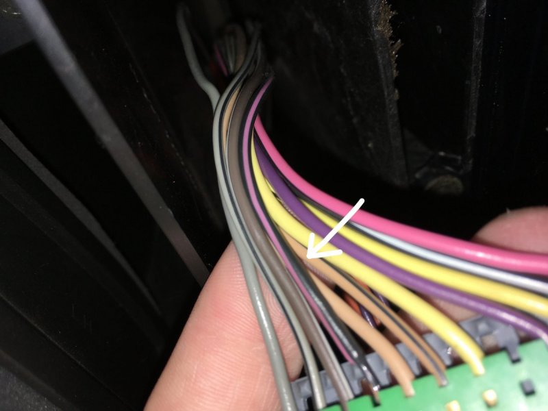

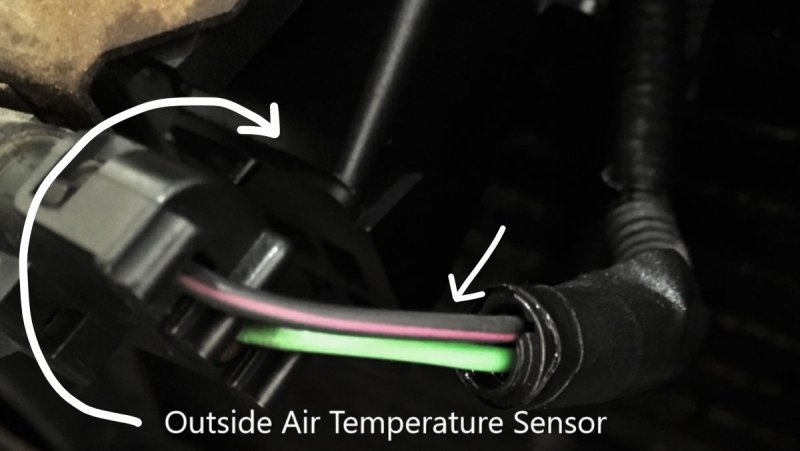

2.  Found a black/pink wire in the front of the car going into the Outside Air Temperature Sensor.  I would normally think this has nothing to do with “Headlights” but it is actually referenced in the “Headlights” section of my 1990 Service Manual and mentions that it is part of the same wire bundle.
3.  Attached photos of the black/pink wire connecting to the Outside Air Temperature Sensor and the green connector going to the Headlight Switch Assembly.  They look identical color/gauge to me.  The Outside Air Temperature Sensor wire might be slightly lighter in color in the photos (i.e. gray/pink) but in person it looks almost identical.

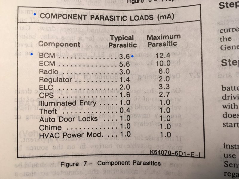

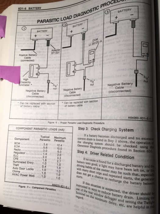

4.  Found a page in the 1990 Service Manual addressing Battery “Component Parasitic Loads.”  In the chart it mentions that BCM draws are typically 3.6 amps – exactly the draw I encounter(d).  Would this potential “headlight-related” short have anything to do with BCM draws?  Maybe this is obvious but I do not understand how components are grouped and added for aggregate draws.
5.  Put blue “dots” by the relevant text in the service manual photos.

1.  Is there “only one” black/pink wire in the entire car?  This is probably a simple question but I do not know if cars usually have unique colored wires for easier maintenance and troubleshooting.
2.  If multiple black/pink smaller-gauge wires exist, do they splice to form a larger-gauge black/pink wire?  I ask this because I can see two instances of a larger-gauge wire black/pink wire running into the engine center relay (photo included).  Does this somehow connect to other smaller-gauge black/pink wires in the car?  (Is this an electrical wiring convention/protocol?)
3.  If I trace the black/pink wire from the green Headlight Switch Assembly connector, would that usually go under the dash and then down to the fuse box?  Or out a wire-run and directly into the engine compartment?  (I don’t know how to find this wire as it disappears into a hole with all the other wires about five inches from the Headlight Switch Assembly).
4.  Can I apply a current to the black/pink wire at the green plastic connector and then see if I get a similar reading at the Outside Air Temperature Sensor "black/pink" wire (or vice-versa)?  Is this too risky?  Is there another way to test this?

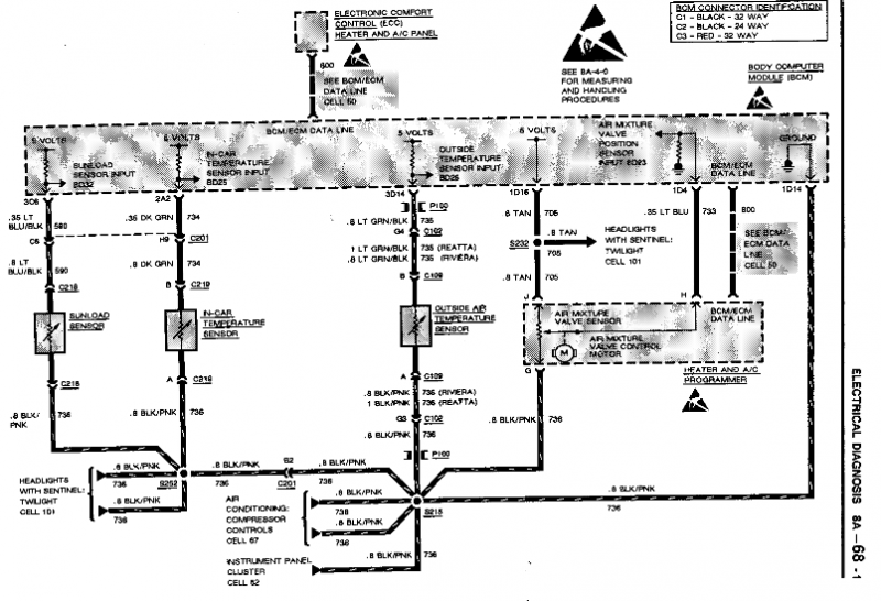

I think 2seater is right. What he said got me to thinking so I started looking for a ground wire with the color code black/pink and I found it. It appears to be a dedicated ground of some sort. It goes to a lot of the components in the HVAC system according to the FSM (see photo). That would account for the black/pink wire going to the outside temp sensor. But, it also says it goes to a headlight switch with a twilight sentinel. Did the '90 Reattas have a twilight sentinel?
I also found a place in the FSM that it show the black/pink wire goes to the Courtesy Lights which is built into the headlight switch. That would account for the black/pink wire going to the headlight switch. And it also goes to the theft deterrent system. Maybe anything that requires a ground to the BCM is that color?
All the black/pink wires come together with Splice S215 located in the wiring harness under the BCM. But they don't go to a chassis ground. They appear to be grounded at the BCM which has a dedicated ground near the battery.
What all this means I honestly don't know. I don't know why a ground wire that is used to signal the BCM to turn on the Courtesy lights would have enough amperage going through it to burn the terminal in the headlight switch connector like it did. I wish I had more to offer in troubleshooting the problem. All I know that you can do is fix what you know is bad first and go from there. Maybe looking up page A8-68-1 in the FSM will help you.

The red connector (with the five wires) is 100% the connector that is causing the constant small orange square to illuminate.  Maybe something else is causing the “Lights On” to stay lit on the digital display (e.g. maybe the replacement headlight switch assembly was always faulty – or a bad signal from the BCM?)  Maybe something else is actually causing the cycling 3.6 amp draw? (Although there is no doubt that when I initially disconnected the HDM connectors that problem seemed to stop)
