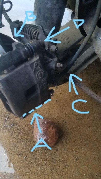

HikingOnThru Posted April 12, 2020 Share Posted April 12, 2020 Hi. 1989 Pewter (sole owner). Good evening. I am in process of getting my Reatta back into road shape. I was the first owner, dated my wife and went to college in this car. As our family grew, the car was less,practical. Left it with family to drive from time to time, but it eventually sat. Just needs paint and brakes. My teenage boys want to help with the restoration. So, today I set out to change the brakes. Front went fine. Rear looked simple. But not so. Got piston compressed, but no room to get pads in. Read on here one has to remove the parking brake bracket? Can someone walk me through the process for the rear park brake bracket removal or point me to a good resource? Thanks in advance. Link to comment Share on other sites More sharing options...

HikingOnThru Posted April 12, 2020 Topic Author Share Posted April 12, 2020 Ronnie, thanks for your input and suggestion. We were able to fully compress the piston all the way using a similar tool. Good thought. I took a picture today that may help illustrate the issue I am running into. I can get the bottom caliper bolt/guide pin out. However, when I try to lift the caliper (A) along the dotted line to rotate it up and put the pads in, the whole shebang rotates as a unit. The brake line (C) limits how far it can rotate. Also, the rear part of the parking brake bracket (B) rotates down hitting other structure and limiting how far up the brake calipers can be rotated up. I would like to know if there is a way to take off the parking brake assemble so I can get the top caliper pin (D) out. The pins need to be greased with silicon anyways. Thanks Link to comment Share on other sites More sharing options...

DAVES89 Posted April 12, 2020 Share Posted April 12, 2020 this is from memory but I believe you have to pull the emergency cable spring back and then you can remove the end through the groove. This will allow you to remove the bracket to then be able to remove the caliper. 1 Link to comment Share on other sites More sharing options...
Philbo Posted April 26, 2020 Share Posted April 26, 2020 On 4/12/2020 at 6:55 PM, HikingOnThru said: Ronnie, thanks for your input and suggestion. We were able to fully compress the piston all the way using a similar tool. Good thought. I took a picture today that may help illustrate the issue I am running into. I can get the bottom caliper bolt/guide pin out. However, when I try to lift the caliper (A) along the dotted line to rotate it up and put the pads in, the whole shebang rotates as a unit. The brake line (C) limits how far it can rotate. Also, the rear part of the parking brake bracket (B) rotates down hitting other structure and limiting how far up the brake calipers can be rotated up. I would like to know if there is a way to take off the parking brake assemble so I can get the top caliper pin (D) out. The pins need to be greased with silicon anyways. Thanks Here is what my 1990 repair manual says about removing the parking brake cable. Judging from the pictures it looks to be the same as the 1989. steps 4 - 8 2 Link to comment Share on other sites More sharing options...
