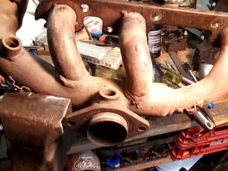

2seater Posted February 9, 2020 Share Posted February 9, 2020 4 hours ago, Ronnie said: O2 sensor is located in the rear exhaust manifold near the transmission dipstick. Dang Ronnie, I expected one of your excellent photos of the little devil? It stands straight up in the rear manifold. Photo of the manifold being prepared for modification; the hole in the stub pipe is for the O2 sensor. Link to comment Share on other sites More sharing options...

Studebaker Posted February 10, 2020 Topic Author Share Posted February 10, 2020 2Seater......There you go.......excellent pic. So that rascal screws right into the manifold from the top......I just went out and looked under the hood.....looks like it will be easy to get to and remove right from the topside. Will start hitting it with PB Blast, get her ready for some wrenching. Glad I have an O2 sensor socket set, and plenty of anti-seize when putting the new one in. Any of you ever try just cleaning the old crud-incrusted sensor and re-using? Link to comment Share on other sites More sharing options...

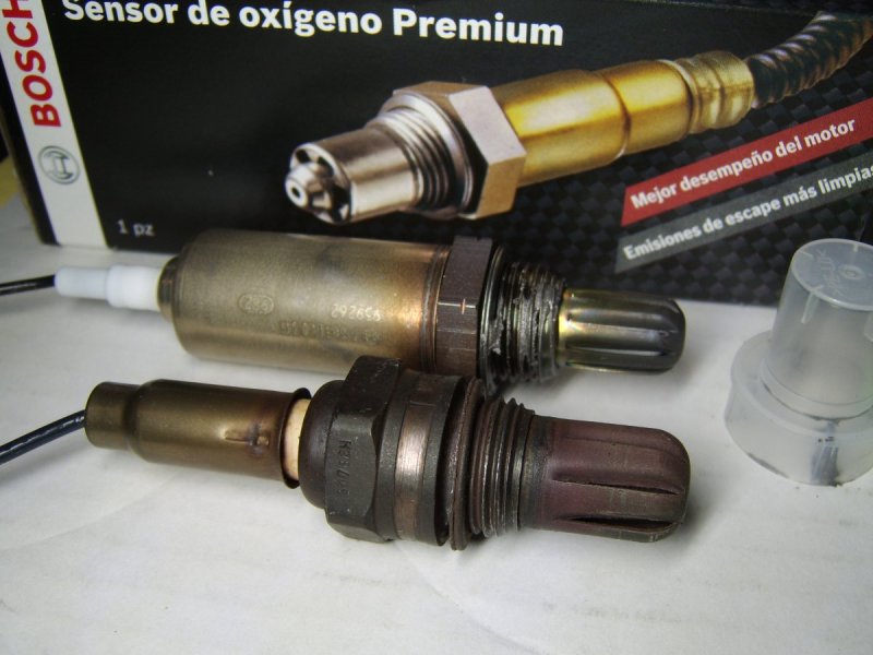

Studebaker Posted February 10, 2020 Topic Author Share Posted February 10, 2020 Here are some pics of the O2 sensor, and removing it: Came out real easy....not stuck like some are. I used the 22mm O2 socket which fit perfect: Not too dirty, but some black carbon did come out when using a wire brush: Cleaned: Stamped "AC Spary".......Could this be original "fac-tree" equipment? New O2 Sensor should be here in a couple days. 2 Link to comment Share on other sites More sharing options...

2seater Posted February 11, 2020 Share Posted February 11, 2020 Great photos. Maybe a bad stamped "K" making a "Y"? I don't think the outside appearance is a reliable indicator of the condition unless it has physical damage. The actual working parts are inside the part with vanes and supposedly there is some form of oxygen content comparison between the ambient air and the exhaust. How that is accomplished I have studied but it eludes me how that is done. They are pretty tough, living in an environment of 1500*F temperatures, high exhaust velocities and turbulence, but are brittle and fragile at the same time. Link to comment Share on other sites More sharing options...
Studebaker Posted February 11, 2020 Topic Author Share Posted February 11, 2020 Ronnie.,.......I agree, would be the best $12.50 fix I have done in a long time. 2seater.........You are right.....just my poor vision in reading the stamp.....It has to be "AC Spark", not Spary. DOH!!! Link to comment Share on other sites More sharing options...
Studebaker Posted February 14, 2020 Topic Author Share Posted February 14, 2020 Got the new Bosch O2 Sensor in and installed it. Old AC one in front, and the Bosch in the back: I installed it and today took the 89 Reatta out for a test drive. The battery had been on charge (low amp) since the prior day, and the battery was at 13.2 volts before I tried starting her up. Only got a real slow cranking attempt from the starter, as if the battery was almost dead. Checked the battery after the failed start, and it was now only at about 11 volts. I then charged it all morning and tried again after lunch......13.4 volts, but a super sick/weak starter action, but just enough to start the V6. Drove her 15 miles on the highway, and came back. GOOD NEWS!!!!!! No "Service Engine Soon" light coming on, and no CRT flashing that "Electrical Warning". So, the new O2 Sensor solved that problem. However, now I have a battery issue. When I was driving, the CRT screen was showing a constant 14.1 volts, but after getting back from the drive, the voltage was 12.8 and slowly dropping. I tried starting, but it was just a flat "umphhh", and the starter did not want to crank. I then checked the battery, and she was reading 11.2 volts. So I need to do a load test on the "new" battery.......I guess sometimes new batteries do go bad. Has anyone else had similar battery issues? Link to comment Share on other sites More sharing options...
