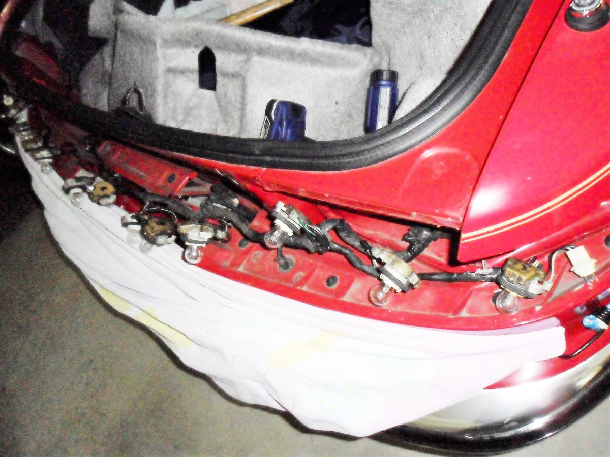

tomsbuick Posted November 28, 2016 Share Posted November 28, 2016 I often get condensation inside the tail light even in light rain or a car wash. I checked the lenses for cracks but found none. Any comments are welcome. Thanks to Reatta Journal. Link to comment Share on other sites More sharing options...
Frogware Posted November 28, 2016 Share Posted November 28, 2016 I also have the same problem and done the same thing but can't find any leaks. So I am wondering what causes this and how the water gets in. Link to comment Share on other sites More sharing options...

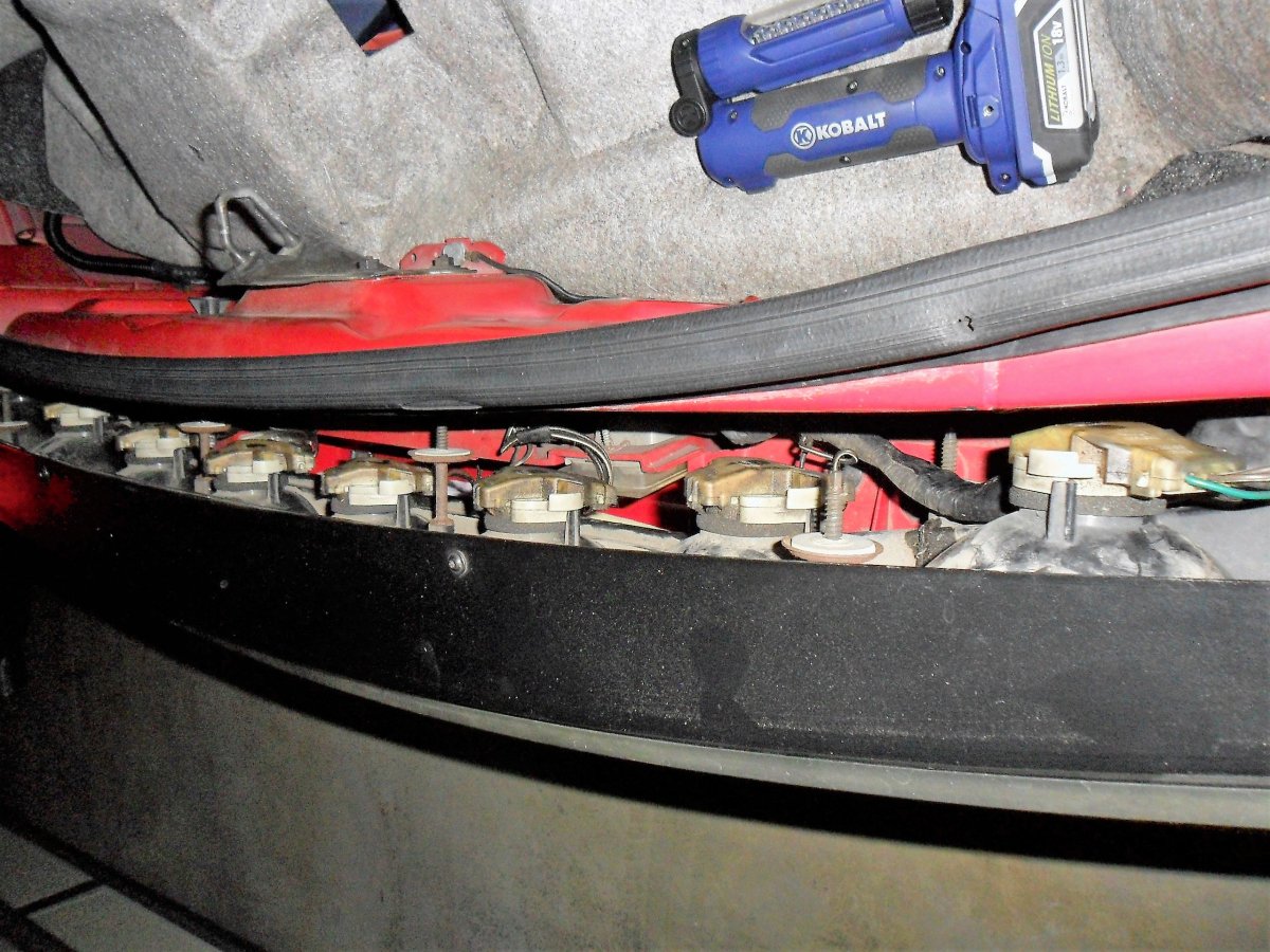

Ronnie Posted August 9, 2019 Share Posted August 9, 2019 The water could be getting in around one of the holes where the bulbs go into the taillight. The sockets that go into the taillight should have seals on them as you can see in the photos below. Link to comment Share on other sites More sharing options...
