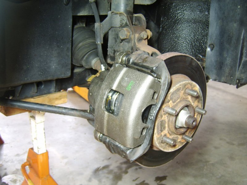

Studebaker Posted December 31, 2019 Topic Author Share Posted December 31, 2019 Bleeding the brakes: After suctioning the fluid out of the master reservoir, I turned on the key and let the pump prime back up, which took about 30 seconds. I then used Ronnie's modified trick of using a wooden stick with a flat end, in a "T" shape to put between the seat bottom and the brake pedal to keep pressure on the brake. With the key on, it was a breeze to bleed the back brakes......no pumping of the brake pedal up/down, but just letting the pump push the new fluid to the back calipers. Took a good amount before clear fluid started coming out, and just had to keep refilling the master reservoir numerous times to prevent any air getting into the system. Here is the front caliper: I tried leaving the key on and hoped that the motor would push fluid out like it did on the rear brakes. But I only got one push of fluid into the clear tube and then the flow stopped. So, this does require a second person to be the foot-stomper on the brake pedal. It seemed to work both ways.....with the key on and pump allowed to cycle, or with the pump off, and just using 100% foot pedal-pumps. Went to the last one (drivers side), and even after soaking the bleeder several days with PB Blast, it did not want to come loose. I even used a torch to heat up the caliper around it, but it still would not come loose......and it may be on the verge of stripping/busting in half. So, looks like a new caliper will be needed on this one. But good to learn how to bleed these Teves Anti Loc Brakes, and to have fresh fluid in most of the lines/calipers. Got to do other general repairs while the car is still up on jackstands, but will post if this solved the ABS warning light issue in the near future. 1 Link to comment Share on other sites More sharing options...

Ronnie Posted December 31, 2019 Share Posted December 31, 2019 9 hours ago, Studebaker said: Went to the last one (drivers side), and even after soaking the bleeder several days with PB Blast, it did not want to come loose. I even used a torch to heat up the caliper around it, but it still would not come loose......and it may be on the verge of stripping/busting in half. So, looks like a new caliper will be needed on this one. If the pads are good, and the front brakes are working good, you might want to consider just bleeding that caliper with the banjo bolt that holds the brake line to the caliper. Use rags to soak up the old fluid that comes out to prevent it from getting on the pads. That would get the old fluid out of the lines but not the caliper. Then when the pads get worn out you can replace the pads and the caliper at the same time and bleed the brakes again. Link to comment Share on other sites More sharing options...
Studebaker Posted January 1, 2020 Topic Author Share Posted January 1, 2020 Ronnie......Great idea, using the banjo bolt to bleed the line on that side. But knowing that caliper bleed screw is gonna break on the next attempt, I might just order a new caliper and put it on........I would hate to forget that its on the verge of breaking, and then bust it off in the future with brake fluid flowing like Niagra Falls, and no way to stop it. Ironically, the computer codes said it was an issue with this front brake......Im hoping it was just the grime on the wheel sensor, but who knows.....maybe there is a huge air pocket inside, or some other issue. Heck, maybe the computer is so good that the ABS warning light was on to alert me that the brake bleeder screw was seized up and about to break off........pretty impressive computer for 1989, and it even survived Y2K. Link to comment Share on other sites More sharing options...

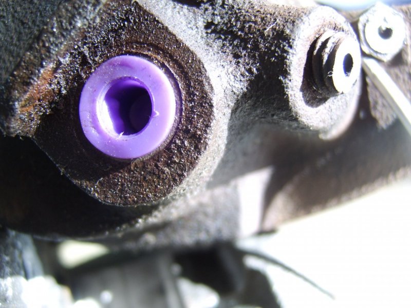

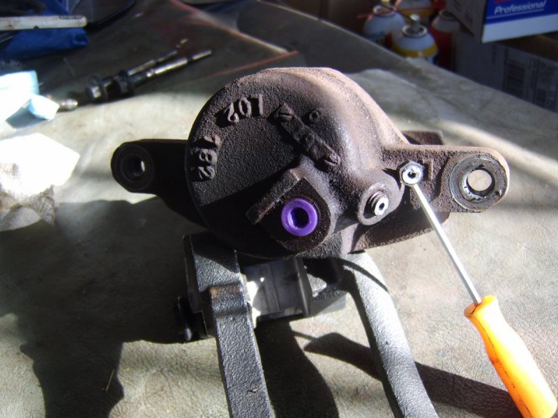

Studebaker Posted January 12, 2020 Topic Author Share Posted January 12, 2020 Got the new front left brake caliper installed, and then bled the brake lines. I then tried to unscrew the old bleeder screw on the old caliper, and sure enough........it snapped right off. So, Im glad I installed the new caliper and did not risk dealing with a busted bleeder screw and fluid leaking out until I could locate a new one: You will notice the new caliper hold-down arm sitting under the old caliper........Advance Auto sent a defective caliper which had the right hand bracket instead of the correct left hand bracket on it. So I had to clean up the old bracket, clean out the caliper pin chambers, add fresh grease, and use the old ugly one....se la ve. (There is a bump-out tab that hits the suspension and cant be used without grinding it off......so, I just went with the old). Took her out for a test drive to see if the ABS warning light would go out after driving over 18mph. At first the ABS light was off, then it came on only when I had my foot on the brake pedal, and would go out with foot off pedal. After driving a few minutes, the ABS light came on and stayed on. So, do I now need to try to "reset" the computer to make the light stay off? The good news is that the red colored BRAKE light now stays off. Link to comment Share on other sites More sharing options...

Studebaker Posted January 13, 2020 Topic Author Share Posted January 13, 2020 And here is an upclose of that busted-off bleeder screw: (more eye candy, right?) So, if that bleeder screw had broken off while the caliper was on the car, what is the best idea to stop the bleeding? Do you grab a piece of Double Bubble bubble gum, pop it in your mouth, chew away for a couple minutes, blow a few bubbles for the hell of it, and then slap that Doubble Bubble all over that busted bleeder screw? Would this last a few days until a new caliper arrives? Link to comment Share on other sites More sharing options...
2seater Posted January 14, 2020 Share Posted January 14, 2020 If the screw simply broke off without moving, nothing would need be done. It wouldn't remain closed and not leak. Bleeding at the hose connection would take care of the bulk of the necessary fluid flow although messy, as originally suggested. Link to comment Share on other sites More sharing options...
Ronnie Posted January 14, 2020 Share Posted January 14, 2020 3 hours ago, Studebaker said: And here is an upclose of that busted-off bleeder screw: (more eye candy, right?) So, if that bleeder screw had broken off while the caliper was on the car, what is the best idea to stop the bleeding? Do you grab a piece of Double Bubble bubble gum, pop it in your mouth, chew away for a couple minutes, blow a few bubbles for the hell of it, and then slap that Doubble Bubble all over that busted bleeder screw? Would this last a few days until a new caliper arrives? The gum would work if it could withstand over 2000 PSI of pressure. ? I believe the bleeder it has the full pressure of the brake system on it when you open it. It might be possible to remove the broken bleeder with an Easy-Out after soaking it with penetrating oil for a couple of days but calipers are so cheap it wouldn't be worth your time. Link to comment Share on other sites More sharing options...
Studebaker Posted January 14, 2020 Topic Author Share Posted January 14, 2020 2 Seater.......I guess you are right, that no fluid would come out if the bleeder snapped off without it turning any.......so, there would be no leak to worry about. No need for the Double Bubble repair job. Bleeding at the hose connection is an option......but you should have seen the BLACK fluid/grime that came out of that old caliper, which would have remained. Ronnie.....With 2000 psi, that would be one HUGE Bubble....probably big enough to drive on it a few miles. I agree.....at $30 for a caliper, not worth the time to repair it. I was just wondering the best course of action if a bleeder did snap off in the future......I was thinking the fluid would be leaking. Link to comment Share on other sites More sharing options...
