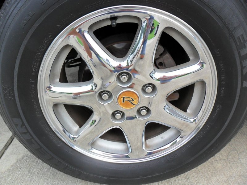

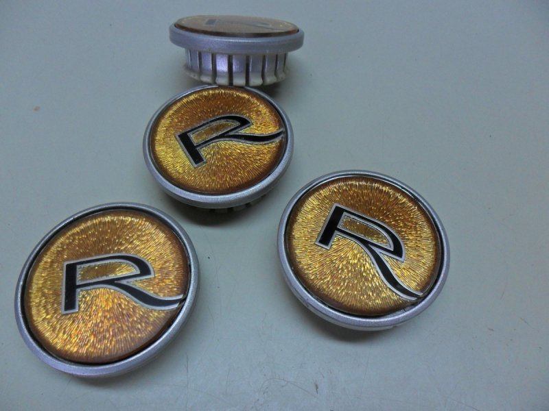

DAVES89 Posted July 28, 2020 Topic Author Share Posted July 28, 2020 Also today I asked my wife if she would do a "nail polish" job on my center caps. She did a great job on all 8 wheels [the 'vert and the Red]. I had the Red this morning as I had appointments to run so she did the 'vert first. She complained that is was too hard to do the center caps on the car so I removed the wheels on the Red to make her job easier. Turned out well. I like using nail polish as it dries to a hard glossy and comes in the dark rich Red,White, and Blue which is the Buick Tri shield colors. 2 Link to comment Share on other sites More sharing options...
Jay Posted July 28, 2020 Share Posted July 28, 2020 On 7/10/2020 at 4:04 PM, Ronnie said: Everything looks good. I like the wheels. For a few bucks you can get chrome lugnuts from Amazon that would look really good on those wheels. They would be like icing on the cake. Where did you find the center caps? Those look really good! Link to comment Share on other sites More sharing options...
DAVES89 Posted July 29, 2020 Topic Author Share Posted July 29, 2020 Jay, I have a set of four I might be able to sell. Link to comment Share on other sites More sharing options...
Ronnie Posted July 29, 2020 Share Posted July 29, 2020 3 hours ago, Jay said: Where did you find the center caps? Those look really good! I made them from some old Reatta center caps. You have to cut them down to make them fit the small center caps and it takes a lot of time. You might be better off buying some from Dave if your time is worth anything to you. 1 Link to comment Share on other sites More sharing options...
