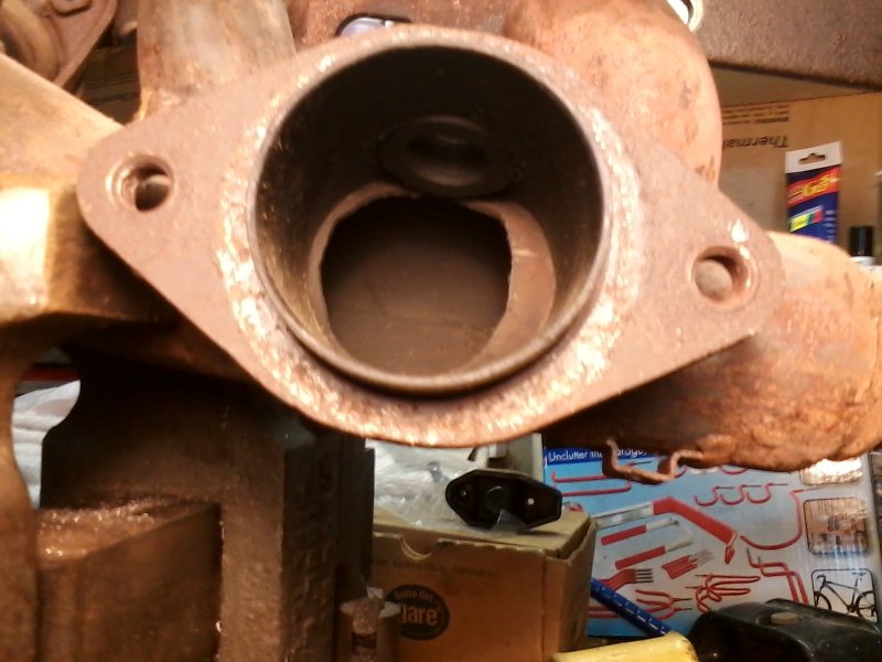

2seater Posted November 25, 2017 Share Posted November 25, 2017 Thanks for all the great information! I will check it out. Installing the cat looks simple enough. I'd have to buy a chain pipe cutter tool. I want to pull off the pipe from the manifold at the same time to grind out the restriction. All this will be on my winter to-do list when it's too cold to drive. Yes, a very good time to remove the restriction. I have never ground one out from under the car, only on the bench. I have done it with a good hole saw or a die grinder. The hole saw should self guide and fit just inside the pipe, something like 2 1/16" but I don't know if there is enough room to get that in there under the car. A 1/4" die grinder with a 3/8" carbide will make short work of opening it up but the pipe is a 400 series stainless steel and is pretty tough. Don't be afraid to remove the O2 sensor bung completely and take the whole thing out to the full diameter, all the welds are on the outside, so no danger of leaks. Link to comment Share on other sites More sharing options...
Ronnie Posted November 25, 2017 Share Posted November 25, 2017 I hope the manifold opening is accessible from under the car. I have a set of large burrs like these. Some of mine are worn or missing but one of them should do the job. I don't have a hole saw that size that would cut metal so I might not be able to get the bung that protrudes into the hole for the O2 sensor cut out. I think my hole saws are only for wood. I'm going to try to find a buddy that has a chain pipe cutter before I start. I hate to have to buy one that will probably not be used again for years. I think I know someone who has one. I usually have some nice days to drive all the way up until January so it will be after that before I take a look at it. Thanks for the tips. Link to comment Share on other sites More sharing options...
