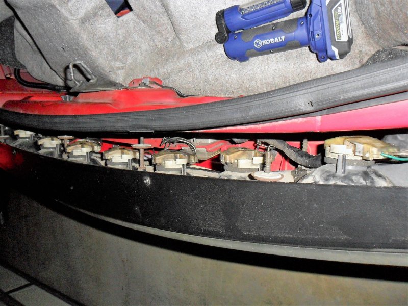

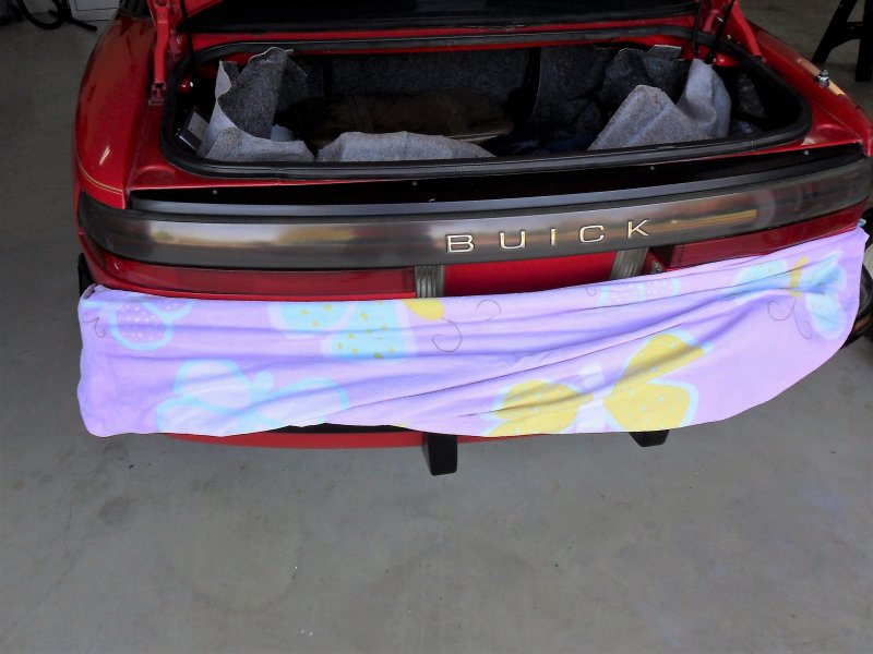

Ronnie Posted October 26, 2017 Share Posted October 26, 2017 Here are instructions Tail Light Bulb Replacement Below a a few photos that might help. Link to comment Share on other sites More sharing options...
2seater Posted October 26, 2017 Share Posted October 26, 2017 How do you remove the Reatta tail lights from the car? The fasteners are inside the trunk under the trunk liner. Fold the lining forward and the plastic thumb nuts will be revealed. The ones on the outer ends are not the easiest to see or access, but the entire assembly slides out to the rear. There are steel cables attached to the assembly to let it hang for bulb access. Be certain to provide protection under the taillight and especially where the end studs contact the corners of the body. Now that I think about it, there is probably a tutorial on the site. Oops, Ronnie beat me to it :) Link to comment Share on other sites More sharing options...
