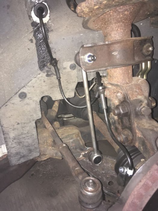

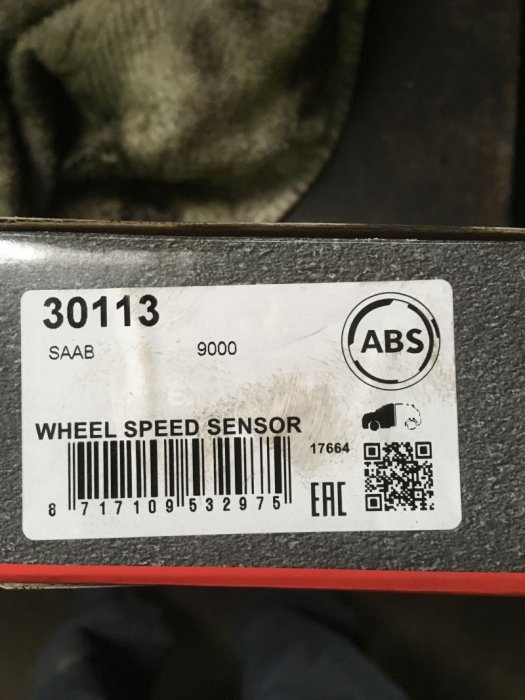

Aztec62 Posted October 21, 2017 Topic Author Share Posted October 21, 2017 Hello all, I have been quite busy to get the front ABS sensor leads for my `90 Reatta. Jim Finn had used ones, DaveS89 had refurbished ones available. I got in touch with the ATE company in Germany, but they were not of any help. Then Dave pointed me to to the fact that the sensor leads for a SAAB 9000 will fit with some small modifications. They are available on Ebay for around 55 Euros (or the equivalent in $$) the pair, the SAAB part number is 24071111511 This is what they look like installed: Link to comment Share on other sites More sharing options...
DAVES89 Posted October 22, 2017 Share Posted October 22, 2017 The error to trip the light has been satisfied and won't come back. Regarding moving the boots, I use a small screwdriver from both ends of the boot and "open up" the boot and squirt in a little soap. Works as good as WD40 but dries better leaving no residue. Link to comment Share on other sites More sharing options...
