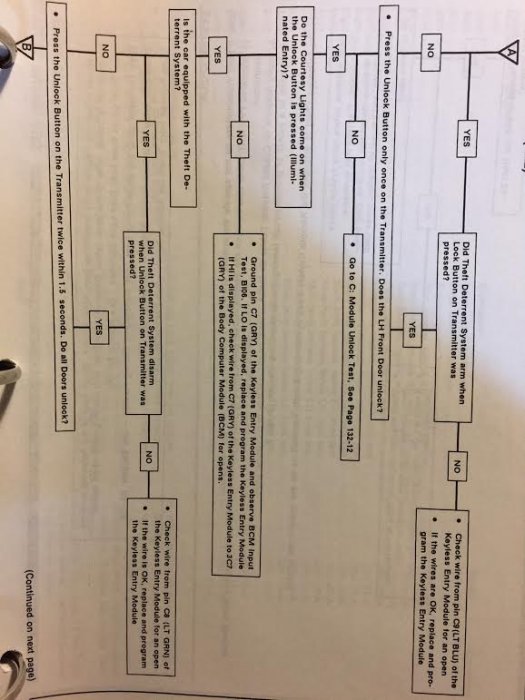

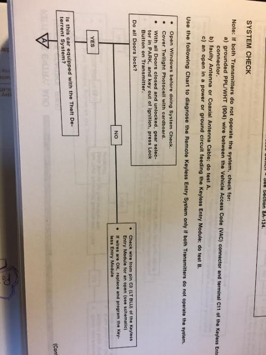

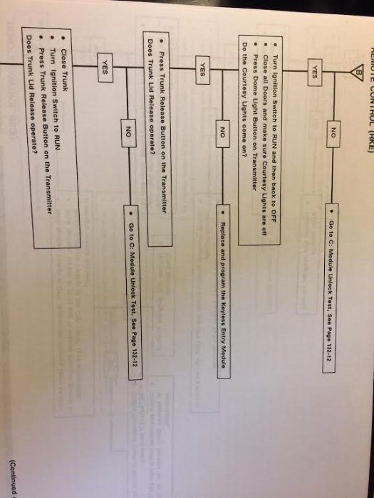

Frogware Posted November 5, 2016 Share Posted November 5, 2016 Yeah I think Dave is right but I don't have the update manual so I can't say for sure if that system was changed. I looked at my manual and there are 18 pages that cover the Remote Entry system, so unless you need something specific that I can post I am not sure what information to post. I did take a few pictures of the first section of troubleshooting the RKE as seen below. This first page shows the location of the modules and such (See Convertible) Continued Link to comment Share on other sites More sharing options...
