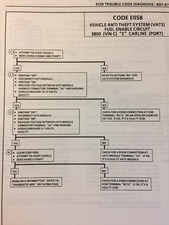

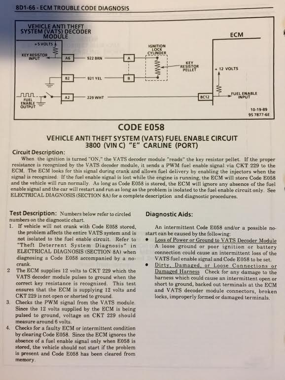

Reattasteve Posted November 5, 2016 Share Posted November 5, 2016 Can someone with a 1990 manual attach some copies of the different service codes. I can't figure out what code would pop up for keyless entry problem. Thanks in advance, Steve Link to comment Share on other sites More sharing options...
Frogware Posted November 5, 2016 Share Posted November 5, 2016 This is the only thing I could find about the Theft Deterrent system, I hope it helps. Link to comment Share on other sites More sharing options...
Reattasteve Posted November 5, 2016 Topic Author Share Posted November 5, 2016 Thank you, appreciate it. Steve Link to comment Share on other sites More sharing options...
