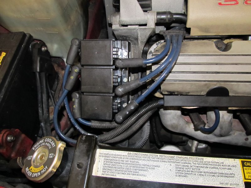

tomsbuick Posted July 17, 2017 Topic Author Share Posted July 17, 2017 On 7/9/2017 at 5:18 PM, tomsbuick said: ;) Greetings Reatta owners. I realize that in the tutorial there is a section on how to change over the Ignition Coil to AC Delco but i wish to keep the Magnavox. I bought a replacement Magnavox but before installation my question is should there be a thermo gasket (i did not get one) between the unit and the mount heat sink plate? I read also they use a thermo paste between the unit and the plate? I have not taken the old one off yet. I guess it plugs in (spray down with wd-40 at bolts and were it mounts). Any Suggestions? I replaced the original coil with a aftermarket Magnavox type but i did some testing with my multimeter and found the secondary coil ohm resistance is different- the original tested 12.9-13. and the new coil tested 6.9. Anyone know if this new coil is safe to use? :huh: Link to comment Share on other sites More sharing options...

2seater Posted July 21, 2017 Share Posted July 21, 2017 This what the book says regarding the standard coil system: The secondary resistance, across the two terminals, should be 10-13k ohms. I measured the two coilpacks I had handy, the first is installed : 13.2k, 12.9k, 13.12k right on the high limit. The shelf coilpack: 11.85k, 11.85k, 11.74k, pretty well in the middle. I am pretty sure the one on the car came from a vendor at a Buick Grand National event many years ago, billed as "hi-performance" and has approx. 55k miles on it. The other is the take-off from the car with about 70k miles. Now this is just supposition, but perhaps the higher resistance value is due to the number of wire turns in a higher turns ratio coil?? I am by no means knowledgeable on this subject but generally lower resistance allows more current (amperage) to flow. Link to comment Share on other sites More sharing options...

Ronnie Posted July 24, 2017 Share Posted July 24, 2017 The D555 coil is the proper coil for a 1991 Reatta with the 3800 fuel injected engine. The D555 is the correct coil that fits a 1992 Pontiac Transport that is referenced in Padgett's ACDelco Upgrade article. It will work fine in any Reatta engine when paired with a matching ICM. I have ACDelco Rapidfire spark plugs (14s I believe) gapped at .060" but .045" would work without damaging the engine too. I've had it on my '88 model Reatta for about 5 years and it works perfectly. I don't know where you got the information that it wouldn't work properly with a FI engine but I don't agree with that. Bottom line is if you feel better about running the Magnavox system you should stick with it but I feel the Delco setup is superior. Link to comment Share on other sites More sharing options...
