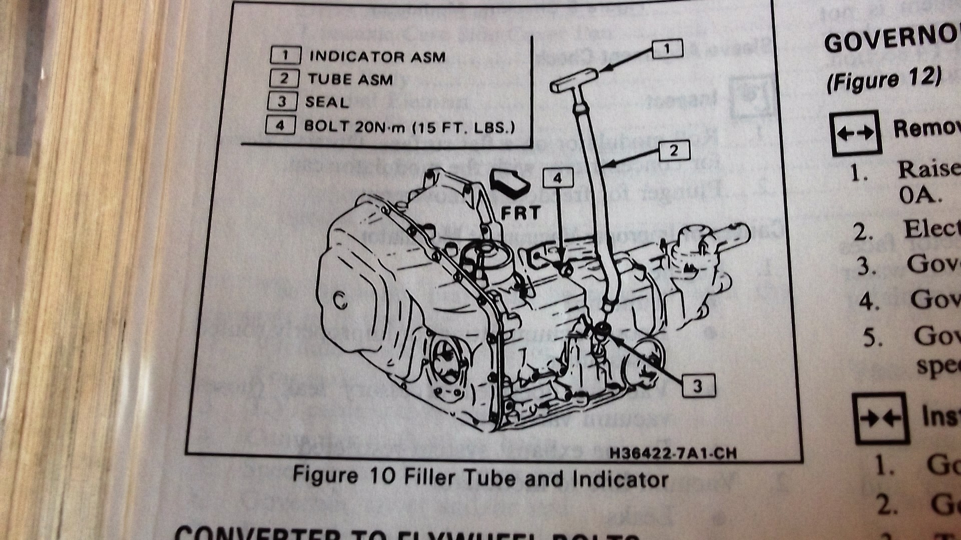

2seater Posted May 1, 2017 Share Posted May 1, 2017 Is it still actively leaking or is it just residue dripping over time? If I remember correctly that connection is above the fluid level and will leak profusely if pulled out. I would pull the stick and lightly tap it down to be sure it is bottomed. Link to comment Share on other sites More sharing options...
AZ Ron Posted May 1, 2017 Topic Author Share Posted May 1, 2017 The drips are probably residue after coming home from a drive. I will tap on it with a rubber hammer and see if that drives it in enough so it does not leak. Thank you! Link to comment Share on other sites More sharing options...
AZ Ron Posted May 1, 2017 Topic Author Share Posted May 1, 2017 I drove the car when I went out to pick up a pizza and put a clean piece of cardboard in my usual parking place. I will see how it looks tomorrow and let everyone know the results. Link to comment Share on other sites More sharing options...
