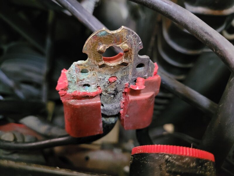

ReattaMondatta Posted September 7 Share Posted September 7 I have been having trouble for years with my 1990 Reatta refusing to start when it is hot. I have scoured the owners journal for leads and have found many...and I have been attacking each possibility in turn (thank you all!). Having taken the side battery terminals off so many times, I thought I might have a risky connection at this point. So I tried copper washers. But the bolt threads weren't long enough to keep things tight. I have a dual terminal battery so I decided to I was going to use a side-to-top-post converter and put new ends on the cables (The larger cables weren't long enough to simply use the existing top posts.) So I proceeded to cut up the red rubber coating over the positive cable ends and discovered some pretty significant corrosion. I thought I would mention it here because from the outside it looked absolutely PERFECT. If you suspect this and just want to eliminate it as a potential problem, you don't have to cut it up (its a miracle I didn't cut my hands). You could just cut the cables below the rubber, of course. So far the car is starting fine...but we'll see...the saga continues... 1 Link to comment Share on other sites More sharing options...
