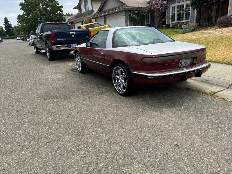

Reatta1melvin Posted August 15, 2024 Share Posted August 15, 2024 I’ve had my reatta over 10 years only has 73k miles my dad gave it to for as my 1st car it just sat in my driveway i drove it maybe every 3 to 6 months always started up and ran April of this year fell in love with it got it smog and tagged It failed the first time reason was gross polluter put a new Cadillac converter and it passed. Even with this sluggish acceleration. No check engine light Getting it going is the hard part once it gets to about 20 mph it gets better but not perfect what are something’s that will cause the sluggish takeoff with no check engine light help please I really love this car and want to pass it down as my father did for me.. Link to comment Share on other sites More sharing options...
