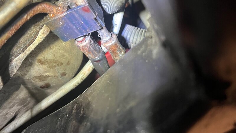

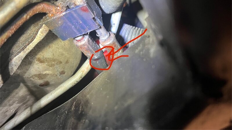

TripleC321 Posted August 8, 2024 Share Posted August 8, 2024 Discovered my transmission cooler line has a leak. See attached photos. It appears to be in the rubber portion. Is there any way to repair the hose or do I need a completely new line? Link to comment Share on other sites More sharing options...
2seater Posted August 8, 2024 Share Posted August 8, 2024 Rust on the steel line is the most common failure point but the crimped on rubber hose is really just a sort of hose clamp. You may be able to salvage the assembly by removing the crimped sheet metal clamp, remove the damaged hose portion and reassemble with two new clamps 90*apart. The best is a crimped type clamp (Oetiker style) 1 Link to comment Share on other sites More sharing options...
