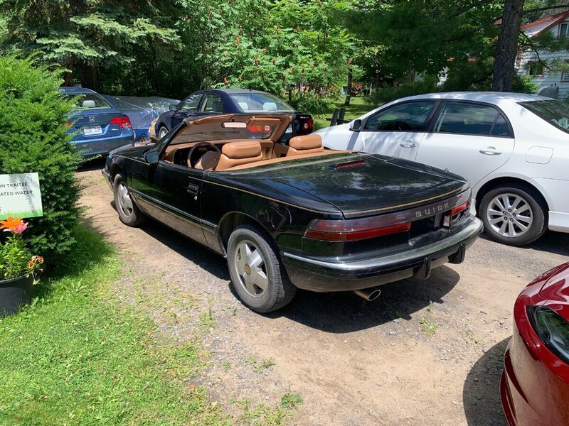

moosefuel Posted July 9 Share Posted July 9 (edited) SO I "accidentally" bought a 1990 Reatta sight-unseen at an online auction about three hours away from me. The car itself is not in bad shape for its age, there are lots of little problems which I'm sure I'll post about here. BUT driving it is made unbearable by one thing, the SMELL! I think it might be moisture (the roof wasn't quite sealed properly), but part of me thinks there must be a dead mouse or five in the dashboard or under the rug somewhere for it to smell this bad. It's a sort of pungent, acrid smell, like rotten plastic mixed with mold and a chemical spill. Has anyone else had a very smelly Reatta? How did you fix it? Right now I'm making plans to remove all the carpets (clean them) and check behind the dash but man, that's going to be a lot of work. Edited July 9 by moosefuel Link to comment Share on other sites More sharing options...

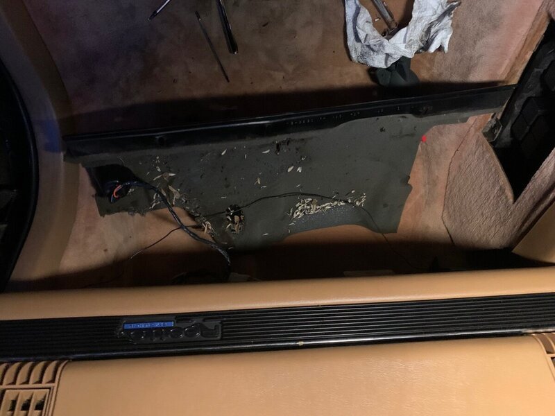

moosefuel Posted July 10 Topic Author Share Posted July 10 22 hours ago, 2seater said: Rodents could have built a nest anywhere. Thanks for the feedback. Looks like I'm carefully going to disassemble the entire interior of the car. Clean it, then reassemble. I did find one dead mouse today, he was inside the brake calliper. Poor little guy. I'll have to be really careful because some of the plastics have become rather brittle and I want to be able to put it all back together again. Thanks again. Link to comment Share on other sites More sharing options...

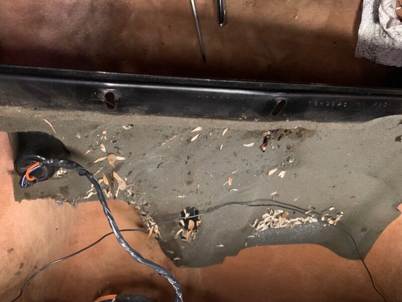

alchemist Posted July 15 Share Posted July 15 (edited) My Reatta sat in a garage/pole building (concrete floor, but no heat) for two years after my father was no longer able to drive. The interior was covered with mildew and there were several mouse nests under the hood that would smell like, well, hot mouse pee when I drove the car. Meticulous inspection from up top and under the car revealed all of the locations. Shop vac with crevice tool followed by steam cleaning got rid of the mouse issue. The interior cleaned up readily using standard cleaners and leather conditioners. I cleaned the carpets (without removing them) with our household hot water extractor unit and everything looks as good as it should for a car with 26k miles. I used Febreeze on the carpets and also sprayed some into the intake for the HVAC when it was running. Edited July 15 by alchemist 2 Link to comment Share on other sites More sharing options...

moosefuel Posted July 18 Topic Author Share Posted July 18 Thanks for the info. I ended up removing the interior, also found a lot of rust and mildew I have to combat. Priority #1 is making sure I fix all the seals to stop water coming in, but it's going to be a challenge and a half to find all the leaks. Anyone ever try one of those ultrasonic leak-finders? Seems like I need some help here. Link to comment Share on other sites More sharing options...
Ronnie Posted July 18 Share Posted July 18 You should check the wire splices under the seats while you have the carpet out. If you have water in there the splices can cause lots of problems. Wire Splice Repair 1 Link to comment Share on other sites More sharing options...
moosefuel Posted July 20 Topic Author Share Posted July 20 On 7/18/2024 at 11:31 AM, Ronnie said: If you have water in there the splices can cause lots of problems. Thanks for the tip! Will-do. On the bright side, I spent the week cleaning, grinding and painting and the rusty floors have never looked better. The car's name is AMY, btw. Link to comment Share on other sites More sharing options...
