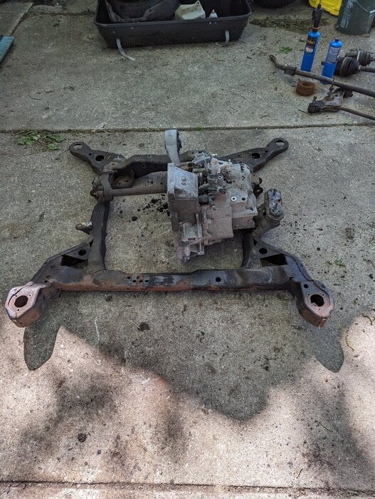

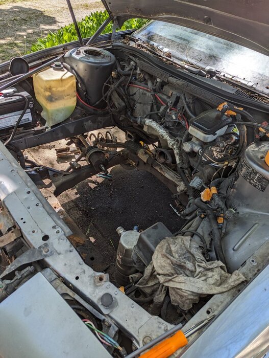

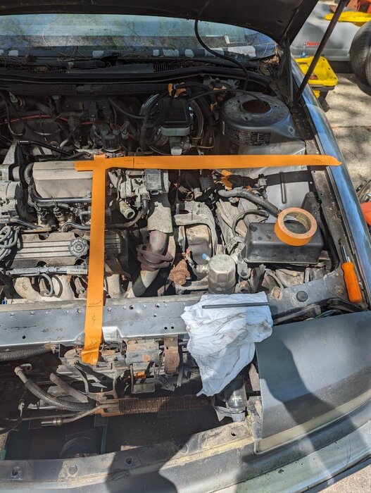

Brock Posted May 26 Topic Author Share Posted May 26 Subframe is out. Yay. Got it cleared of all it's extra stuff so I can measure where to mount the new trans. Even plopped the new trans it it's hole. It's a ways away from where it has to be in these pics, so don't worry. Man, there are a ton of rubber bushings in this thing. I got all six subframe bushings waiting to be installed. Now I have to order control arm bushings and sway bar bushings and sway bar end link bushings and bushing-bushings for the bushing that bushings. Oof. No wonder these cars are so quiet going down the road! Next step is to get the trans located and find a mock-up Series II 3800 block. Hopefully tomorrow. 1 1 Link to comment Share on other sites More sharing options...

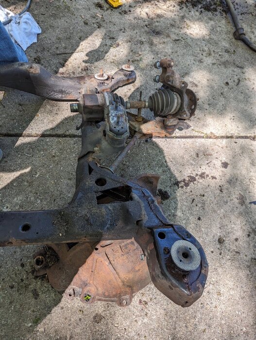

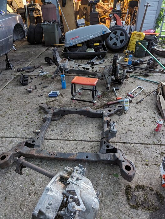

Brock Posted June 3 Topic Author Share Posted June 3 Rear Subframe is out now also. Want to refresh all the rubber, paint it up, swap in a lowering spring I bought years ago from a place in Ontario and some aftermarket struts that were custom machined slightly incorrectly for me... Fun! Man did I make a mess! Problems - Bushings. All mine are toast. All of them. Holy-o-mackerel. None are available. The Cadillac mounts that were the go-to swap for the rear mounts have been discontinued. Going to spend some time paging through catalogs to find the bushings. I'll post what I find. Link to comment Share on other sites More sharing options...
