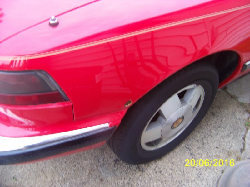

2seater Posted April 3, 2017 Share Posted April 3, 2017 That area should be steel? Test it with a magnet but that chip looks quite thick, like filler popped out, maybe a trick of the light? Was that area possibly repaired before? Link to comment Share on other sites More sharing options...
Frogware Posted April 3, 2017 Share Posted April 3, 2017 Yeah I agree with 2seater it should be metal. The front fenders are the Plastic/fiberglass composite of sorts and I think they are similar to the C7 Corvette SMC (Sheet Molded Compound) but don't take that as truth it is just what I was thinking. Link to comment Share on other sites More sharing options...
Posti Posted April 3, 2017 Share Posted April 3, 2017 Reatta body components are all steel - no plastic or fiberglass, except in the filler pieces. Link to comment Share on other sites More sharing options...
Ronnie Posted April 3, 2017 Share Posted April 3, 2017 Reatta body components are all steel - no plastic or fiberglass, except in the filler pieces. Do you consider the front fenders filler pieces? Front fenders are some type of composite, not steel. Be careful leaning on or pushing on them. They can crack. I don't understand why GM used plastic front fenders and then used a hood that weighs as much as a Volkswagen and is strong enough to walk on. Rear quarter panels are steel down to the bottom seam where composite panels bolt on to them. Link to comment Share on other sites More sharing options...
Reattasteve Posted April 3, 2017 Topic Author Share Posted April 3, 2017 That area should be steel? Test it with a magnet but that chip looks quite thick, like filler popped out, maybe a trick of the light? Was that area possibly repaired before? Unknown. After I bought it I noticed an X shaped crack. I tapped on it and was left with a hole. Do you consider the front fenders filler pieces? Front fenders are some type of composite, not steel. Be careful leaning on or pushing on them. They can crack. I don't understand why GM used plastic front fenders and then used a hood that weighs as much as a Volkswagen and is strong enough to walk on. Rear quarter panels are steel down to the bottom seam where composite panels bolt on to them. OK. Good to know on what I use for filler. Yeah I agree with 2seater it should be metal. The front fenders are the Plastic/fiberglass composite of sorts and I think they are similar to the C7 Corvette SMC (Sheet Molded Compound) but don't take that as truth it is just what I was thinking. Thanks Link to comment Share on other sites More sharing options...
Ronnie Posted April 3, 2017 Share Posted April 3, 2017 To do the job right you will need to get all the old body filler off, clean and repair the metal, and then refill with as little body filler (Bondo) as possible. Thick Bondo won't flex and the result will be cracking as you have seen on your car. Link to comment Share on other sites More sharing options...
Reattasteve Posted April 4, 2017 Topic Author Share Posted April 4, 2017 To do the job right you will need to get all the old body filler off, clean and repair the metal, and then refill with as little body filler (Bondo) as possible. Thick Bondo won't flex and the result will be cracking as you have seen on your car. OK, Thanks Link to comment Share on other sites More sharing options...
