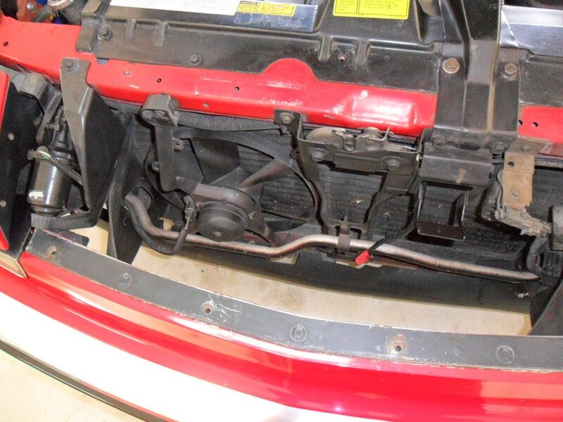

Ronnie Posted March 19 Share Posted March 19 Remove the plastic cowl from over the radiator so you can see what's preventing the headlight from coming up. You can probably remove the linkage from the crankarm with the cover removed if needed. Â Link to comment Share on other sites More sharing options...
DAVES89 Posted March 19 Share Posted March 19 The only thing I will add to the How To is that I remove the top bolt holding the reinforcing plate next to the headlight motor and push it away from the motor to give me clearance to get at the motor arms. Link to comment Share on other sites More sharing options...
