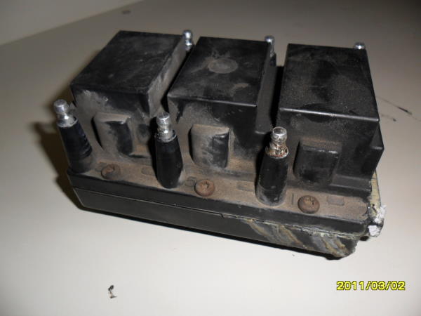

Ronnie Posted February 10, 2017 Share Posted February 10, 2017 You really need a good spark tester. You need to know for sure it is getting a good spark before trying to troubleshoot the fuel system. I'm thinking it is getting a weak or no spark when it won't start. Since it is spraying fuel the crank sensor is probably good. Have you checked to see if there is gray goo on the side of the Ignition Control Module like you see in the photo below? That is a sure sign the ICM is bad. Link to comment Share on other sites More sharing options...
