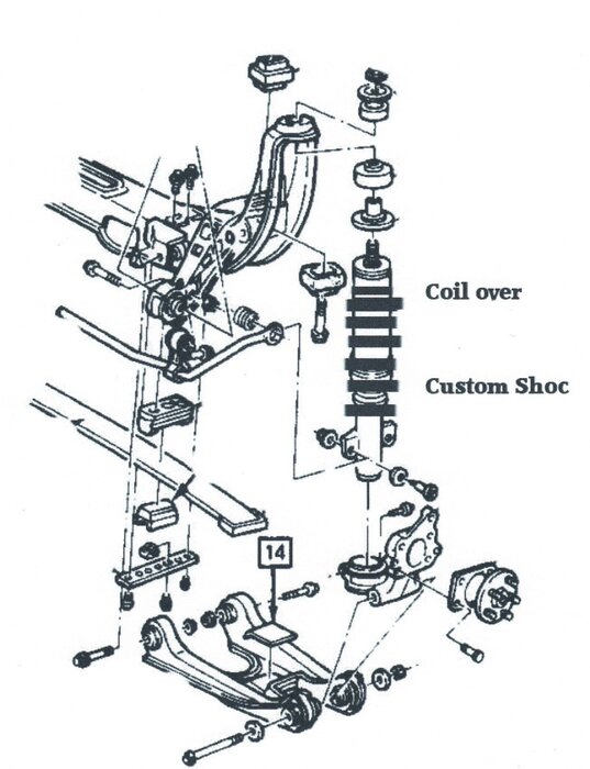

jon L Posted May 16, 2022 Share Posted May 16, 2022 Looking for an opinion on the rear shock tower. Do you think the tower can handle the weight and eliminate the leaf spring? Link to comment Share on other sites More sharing options...
Ronnie Posted May 16, 2022 Share Posted May 16, 2022 The shock tower looks pretty strong but it's really hard to say. I'm wondering if a coil spring big enough to support the weight of the car would fit in that space. There isn't much room around the stock shock at the top. Link to comment Share on other sites More sharing options...
Padgett Posted May 16, 2022 Share Posted May 16, 2022 I broke both front shock towers in my Sunbird autocrossing. Also used to crack hubs in steel wheels. GM mad thigs as light as they could. I'd suggest strengthening. Link to comment Share on other sites More sharing options...
jon L Posted May 16, 2022 Topic Author Share Posted May 16, 2022 Ronnie, coil-overs are much thinner, even with the coil spring. As far as springs go, they are rated up 900lbs for each side. And by running up the adjustment on them up you can support more weight. 1 Link to comment Share on other sites More sharing options...

Guest Posted May 17, 2022 Share Posted May 17, 2022 I looked into this option and it looks like a 2.5 inch coilover should work but without strut tower support and condition of sub frame,fatigued of the strut tower over the years. It is to risky for my taste. Link to comment Share on other sites More sharing options...
alchemist Posted May 17, 2022 Share Posted May 17, 2022 I agree with other comments already posted. Being a metallurgist, I would be very concerned about substantially higher stresses and associated fatigue from putting all of the suspension dynamics through the shock tower. Link to comment Share on other sites More sharing options...
