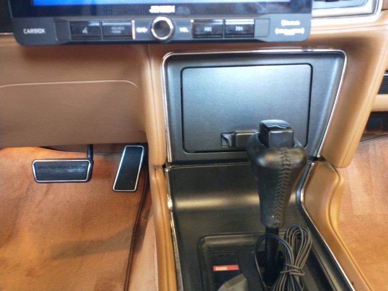

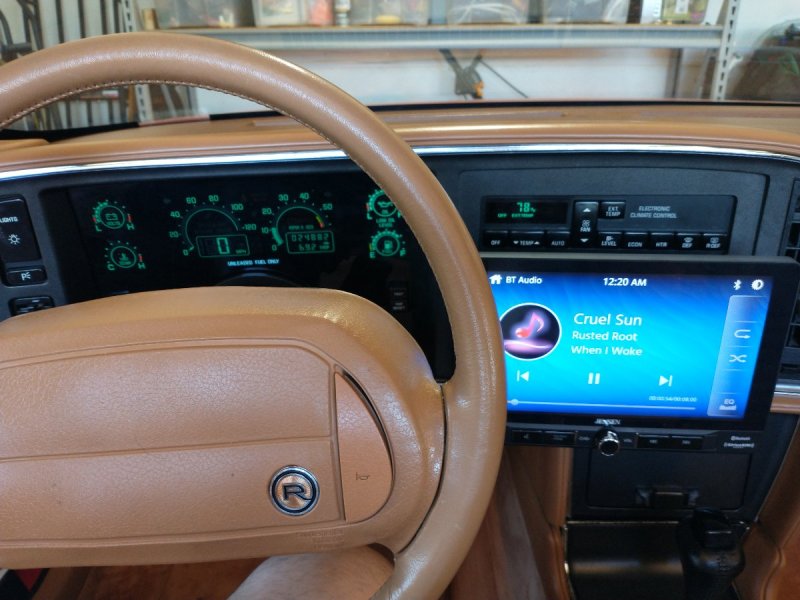

alchemist Posted June 12, 2021 Topic Author Share Posted June 12, 2021 Hello Everyone, Quick update to my little project. Ordered and received the following parts and will be completing the install later today. I cobbled everything together first to confirm everything works and fits. Jensen CAR910X 9.1" display receiver. Metra 70-1858 Wiring Harness Adapter Metra 99-4644 GM Multi Kit 1.5 DIN to 1.0 DIN Adapter Metra 40-GM10 Antenna Adapter Wow, the difference is amazing already. All of the snap-crackle-pop is gone, but I quickly found the drivers door speaker is toast, so next on the money drain is new speakers all around. I have to admit the Jensen looks a little out of place in a 1990's vintage vehicle, but it has all of the functionality I wanted including Android Auto (and Apple Car Play) and the ability to add a backup camera and SiriusXM radio (I have a subscription in my car so I just stream it via Bluetooth from the phone app in the Reatta). I will post some pictures tomorrow when everything is buttoned up. Cheers, Steve Link to comment Share on other sites More sharing options...
alchemist Posted June 13, 2021 Topic Author Share Posted June 13, 2021 The install is complete and went smoothly. All of the appropriate things work which means that I am not completely color blind. Had to install new speakers, so I ordered Kicker 4x10 rear speakers (47KSC41004) and Infinity Reference 5032CFX for the front. The sound is so much better now. I am OK with the look of the unit as-installed, wish I could have found something with a smaller screen that would have worked, but this is good. I kept all of the stock parts in case a purist ever purchases the vehicle, assuming I sell at some point. Link to comment Share on other sites More sharing options...
