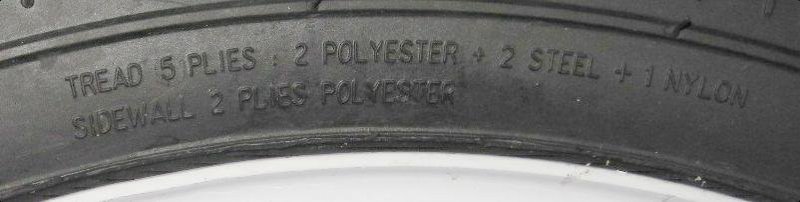

Padgett
" tire technology has come a long way since 1988, and that the recommendation is now somewhat obsolete." Not true, is still valid for stock tires, that said I have been running 225x60x16s on factory 16x7 wheels (like crosslaces) for  several decades. Fiero had bigger wheels and tires & never thought 215s looked right.
ps biggest change has been the addition of a nylon cap/ply under the tread, keeps the tread from coming apart.
Edited by Padgett
