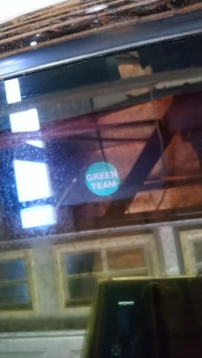

fun car guy 27 Posted February 28 Share Posted February 28 And then there's another question. On the back of the rear view mirror there is this sticker. Wondering if it has anything to do with the craft center. Link to post Share on other sites
