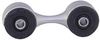

Ronnie 340 Posted January 18 Share Posted January 18 I wonder if it could be caused by a worn engine strut commonly called the Dog Bone? It helps control the rocking back and forth of the engine. It is common for the rubber bushings in it to wear out allowing the engine to move more than it should. Here is a photo if it. It is mounted between the engine and the radiator support. 1 Link to post Share on other sites

Bertimus 33 Posted January 20 Author Share Posted January 20 4 hours ago, 2seater said: Analytical mind at work🙂 That does lend support for the engine/trans moving around. Has your mechanic checked the drive axles for play? Usually axle issues give a noise or vibration indication and are generally very reliable, so just a question at this point. @Ronniedid mention that the rubber bushings in the engine struts (aka dogbones) are prone to wear, causing rocking. Haven't seen my mechanic yet, that will be on Friday, I'll will keep you guys updated! Link to post Share on other sites

Ronnie 340 Posted January 20 Share Posted January 20 It's easy to check to see of the dogbone or something in the driveline is causing the problem. Just start the engine and put your foot on the brake in the driveway. Shift the transmission back and forth between drive and reverse. Listen to see if you hear a clunk. Link to post Share on other sites

Bertimus 33 Posted February 9 Author Share Posted February 9 Checked out the engine struts and mounts. They were okay. The car was lifted and revealed that the transmission was worked on/upgraded by a previous owner. Thicker/stiffer springs are most likely the culprit of the slight jerk. Totally normal and harmless as far as one can tell. Link to post Share on other sites
