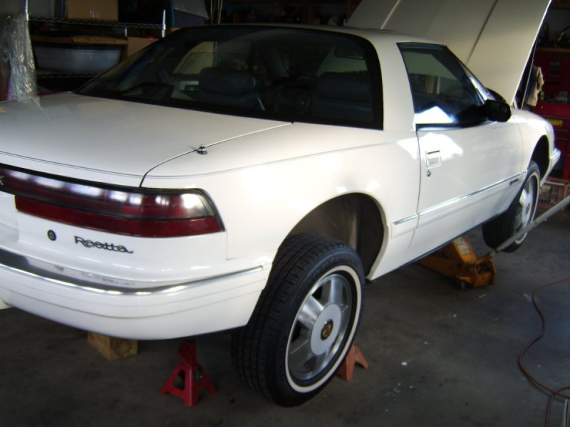

Studebaker Posted December 6, 2019 Share Posted December 6, 2019 I have an 89, and I just jacked her way up to do some over-all maintenance.......and I tell you, this car is super lite in the butt. I would be nervous driving fast on a super curvy road with low fuel in the tank......you need every bit of that fuel weight to help keep those rear tires on the road. Im guessing the weight ratio is about 65% Front, 35% Rear. I would like to know the actual specs. Link to comment Share on other sites More sharing options...
2seater Posted December 7, 2019 Share Posted December 7, 2019 This is from a previous suspension thread: Anything I could say would only be a guess. You are going into uncharted water as far as I know. Here is what Barney said about Reatta weight in a post he made on the other forum. If that is correct 500 lb springs per side on the rear should put you in the ballpark. That's assuming you plan to remove the stock spring. Quote From an early spec sheet released with the 1988 press information........ Curb weight = 3350 Front = 2241 Rear = 1104 67/33 front/rear Link to comment Share on other sites More sharing options...
Studebaker Posted December 7, 2019 Share Posted December 7, 2019 2 Seater.......Thats pretty cool......I was just making a quick guess based on how my floor jacks squealed when I pumped up the front and rear of the Reatta. So my guess of 65/35 was pretty close. Link to comment Share on other sites More sharing options...
