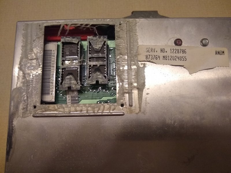

So I decided to go ahead and at least pull out the BCM.  What I found was that the cover to the EPROM was made of duct tape!  I don't know if this has had any real effect on the BCM but it surely could not help.

Those EPROMS look nasty.  I hope they are still good. Normally you would transfer them to the new BCM. One of them holds the mileage of the car.  If you get a BCM from Dave I think you should try it "as is" without changing the EPROMS first. If that solves the problem then you can put your EPROMS in and see if it still works correctly.

Once the "new" used BCM was installed my CRT started working.  I found that I could install the EEPROM and retain my mileage and have the CRT work.  Mileage with correct VIN show 29,3xx. When I installed my old EPROMM (the longer of the two) the CRT would not work.
