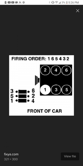

Philbo 54 Posted yesterday at 12:43 AM Share Posted yesterday at 12:43 AM For ensuring the spark plug wiring is correct here is the diagram. I was thinking if not the MAF it could be a faulty Idle Air Control valve maybe? I think that would only cause the problem at idle though. Link to post Share on other sites

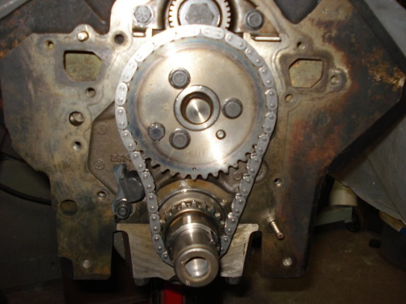

2seater 190 Posted 10 hours ago Share Posted 10 hours ago Perhaps there are memories of the old days when GM and perhaps others used a synthetic or synthetic coated timing sprocket which did break down and chip off. The 3800 has an all steel timing set with a tensioner. The photo is of a workup on a junkyard project engine but is the typical setup. In this case it is using the original (old) style tensioner. The only thing the chain drives is the camshaft and the balance shaft. There is no load from an oil pump as that is crank driven. This is also a non-interference engine as well. 1 1 Link to post Share on other sites
