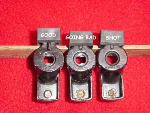

For the headlights, before you go spending lots of money on  rebuilt motors, there are two common problems that you can fix yourself.  The first is the bellcrank. That is the arm that the motor turns that opens the headlights (see first photo). The bellcrank is made out of magnesium, which is quite soft and so the output shaft of the motor, which is hardened steel wollers out the keyway on the bellcrank over time. Mine had the same problem when I bought it.  The 2nd thing it could be are the 3 circular rollers inside the motor gearbox (photo 2). The original ones deteriorate and crumble. Mine were ok but I replaced them anyway.  There is a guy over on the aaca forum named Barney Eaton that sells a kit to fix both problems for $45 per side. Comes with detailed installation instructions as well. His contact info and parts catalog are pics 3 and 4.  Hope this helps.

In examining my headlights I can clearly see the motors and guess how they connect to the pop up lights.  My question is do the bell cranks affix to the motor shafts just by a flat side on the shaft or is there a set screw that might just need tightening?  On my car the right one jumps up and down while the other doesn't move at all.  I'd hate to spend $90.00 for new parts it they're not needed.
Here are photos of the two main things that go wrong with the headlight motors. The flats wear out inside the bellcranks. No set screws.
Thanks to Barney for the photos.
fun car guy
Ah!  So now I fully understand, thank you!  It's good to know what to expect when you're going into unfamiliar territory, now I fully understand how they work so most likely I will need the bell cranks and rollers.
