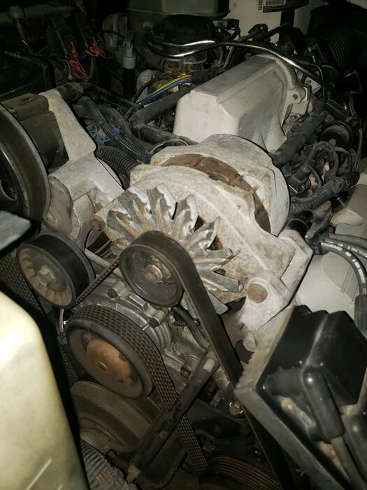

Purchased a refurbished alternator from Rockauto. It arrived with a round steel plate between the fan and pully... which I have NEVER seen before. It's a Remy. It certainly dosent look appropriate for the period either. Has anyone experienced this before? Not sure if it was simply to protect fan for shipping from manufacturer or if it is how they come to be installed. Considering returning. Let me know your thoughts... thanx!32654.thumb.jpeg.7d881c530a0c1671944ccb4aefd94917.jpeg32655.thumb.jpeg.0cce1de8ba9a0877a8664003dffb719f.jpeg
That’s not unusual. This is a pic of my 140a from a junkyard engine. The air is pulled in the back of the alternator over the rectifier and brushes and exits through the fan. It probably increases efficiency of the fan by reducing turbulence. As long as the belt lines up, it is all good360B1A7F-E4A0-432A-89F8-AF31E5AAFF28.thumb.jpeg.d399548bf5225d9714a9762fb4dd07bc.jpeg

Interesting. I guess I'll just go ahead and install it. I've just never seen a GM alternator designed like this. Does make better sense though as far as efficiency. Thank you.

The plate is on a 140amp alternator vs. no plate on a 120amp alternator.
That seems very possible. I am trying to get a sense of the dimensions of the two original photos. I know I was concerned about the 140a being one inch larger diameter, but that was a non-issue. Since the fan is approximately flush with the case in all the photos, my assumption is the plated fan is also larger diameter? Does the replacement alternator match in external dimensions?? Both will bolt in just fine.

CS 144 is a great alternator.  However is a "large case", plug wires may not fit under.
It was exactly the same size and fit like the original.20230113_202309.thumb.jpg.a567e588f80cb59fb6b5d66f85657bae.jpg

Thought the original 120A was a small case and 140A was a large case but looks like can still run plug wires under the alternator.
