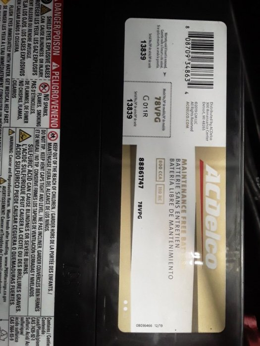

Bertimus Posted January 26, 2021 Share Posted January 26, 2021 So a over a month ago I was experiencing the fabled battery drainage that is commonly associated with Reattas. Many attribute the drainage to a variety of parasitic draw issues usually from something electrical because of the car's numerous futuristic features (for it's time) My 88 had an aftermarket Interstate battery. For the most part Interstate batteries are considered very reliable batteries. When I presented the drainage issue to my mechanic he suggested that all it needed was the EXACT battery that was designed for the car. I was skeptical. He contacted AC Delco and gave them my vin and ordered their suggestion. It's been over a month (I wanted to wait to test it out) and so far it seems to have resolved my issue (knock on wood! ?). I really only drive the car once every one or two weeks, so it sits quite a bit. I'm relieved to report it's been starting like a charm. With the interstate battery I had to jump it at least once a week, before I decided to put it on a tender. I'll report back on here in a month or two with another update. Just thought I'd share this learning experience and hopefully save a future newbie (like myself) a headache or two The battery is an AC Delco Gold 78VGP / G011R (comes with 42 month warranty) and is pictured below (double click image to enable zoom): 1 Link to comment Share on other sites More sharing options...
Bertimus Posted March 17, 2021 Topic Author Share Posted March 17, 2021 So I'm back with another update: the 88 sat for exaclty one month without being turned on, and she started right up! Very happy with this battery and very much worth the extra money. Will post any future updates here. 3 Link to comment Share on other sites More sharing options...

Bertimus Posted March 17, 2021 Topic Author Share Posted March 17, 2021 1 hour ago, artibus said: Well I'll be! My 90 has had similar battery problems. I had no idea it was a common issue with these cars. I'm gonna try the new battery , Thanks for the info! If I can save the headaches I went through for a fellow Reatta owner, then I feel like I'm positively contributing to the community! An alternative solution that many people have resorted to are killswitches! It's so common that I see Reattas all the time for sale with the switches already installed. Happy to help 4 Link to comment Share on other sites More sharing options...
