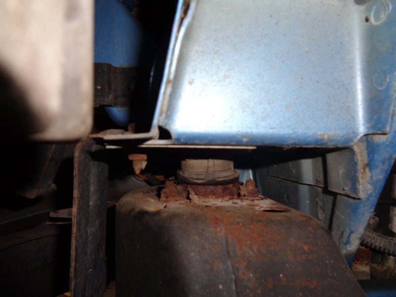

New to the Reatta world so forgive me if this a stupid question but... my subframe bushings are rusted pretty bad. I've got the front end suspension torn down and it would seem the opportune time to try and change these. Is the procedure listed here on the ROJ correct also for a 1990? Those front two bushings look totally different than the rearward other 4. ROJ procedure says replace all 6 with the same bushing but just wondering if this applied to all model years or if the 90 was different. Thanks for any help on this, just not wanting to start something that might not be possible to finish!
Pictures of the rear two and the front one on the driver's side... also wondering why the gap between the top of the subframe and the car body is so much smaller on the rear 4 mounts that the gap on the front two mounts?

The procedure is the same for all 4 years. There may have been different bushings for the front two but as our cars are so old and those parts are discontinued we are now using the one size fits all procedure.
 Be sure to get the correct bolts as the ones in the Dorman kit are the wrong thread.
  • Thanks 1
The four rear mounts are the critical ones, the front being more of a locator. The Dorman mounts we are using now have a greater contact area and seem to really tighten up the front end. The correct bolts are available through GM dealerships online and I have found the shipping charge to be a relatively fixed amount so ordering extra makes the per unit cost less. Bolt part number is 11517635
  • Thanks 1
I updated the How-to guide on replacing cradle bushings with a warning to make it clearer that the bolts that come with the Dorman bushings will not work on the Reatta.
  • Thanks 1
