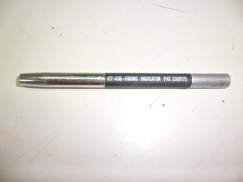

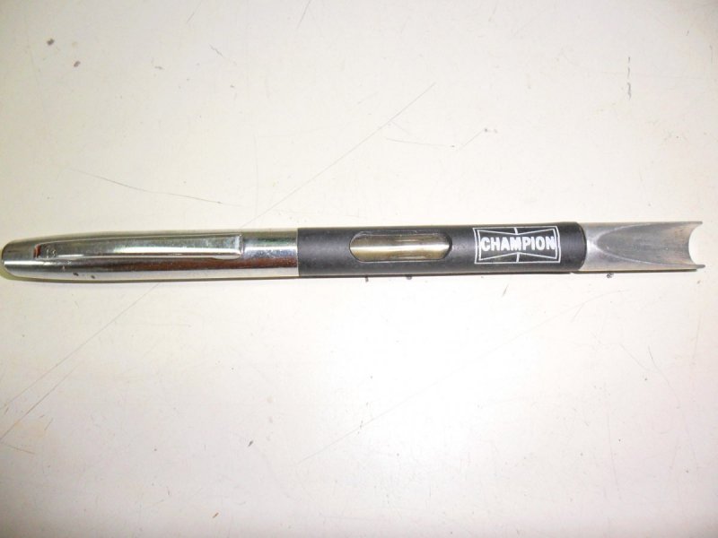

7 minutes ago, Ronnie said:
This is my go-to spark checker that I use in the garage. You just lay the U shaped tip of it on the spark plug wire and the fluorescent tube to the left of the word "Champion" will flash if the wire is getting spark. The U shaped tip rotates so the flashing tube can be turned toward you when the tip is on the spark plug wire.  A lot of mechanics carry them because it is the shape and size of an ink pen and it can be carried in you shirt pocket so it's always handy when you need it.  I've had this spark checker for over 30 years and it still works.

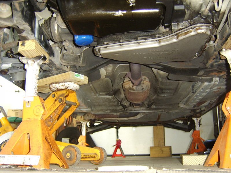

But it is kinda hard getting underneath pics with it only raised up with jack stands:

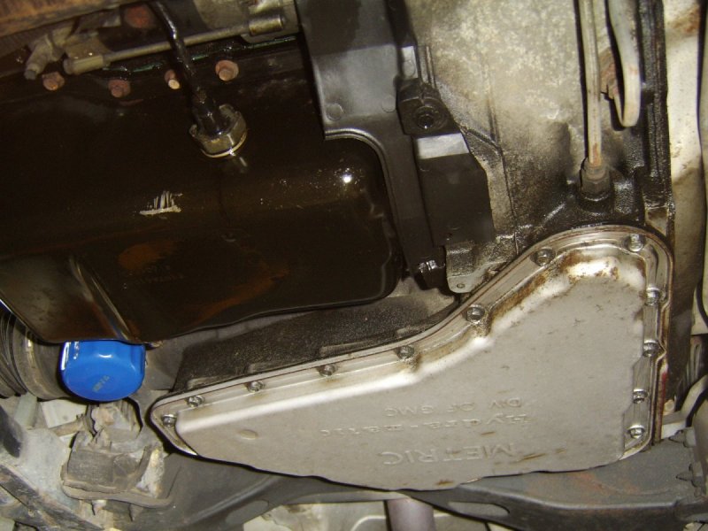

In this pic you can see that the oil pan has a plastic shield on the right side.  I noticed that there was a slight oil leak on that end, and it was due to the fact that this plastic cover must be removed before tightening the oil pan bolts on that end........and i guess the prior owner did not want to deal with the extra effort.  So, those end pan screws were pretty loose.....you may want to check yours also.
Up close:
Share this post
