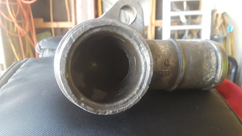

No thermostat found in manifold which explains the 140 degree readings on the freeway the other day.  The thermostat I got from auto parts is the same diameter as the hole in the manifold, but it appears to cause the housing to stand up and get cocked in the manifold. Are the thermostats supposed to fit down inside the recess end of the housing?

Well, it is STILL running about 155 degrees on the freeway even after a 195 degree thermostat was installed. Not even sure what to think now....

Is the rubber ring gasket in place between the outlet elbow and the 'stat? Some use a rubber holder for the stat but it will bypass badly without it

This has came up before.  2seater is correct. There is a rubber "seal" that goes on top of the thermostat with the water-neck pushing down on it to seal the thermostat to keep water from going around it. There is also an o-ring that goes around the water-neck to seal it.
The photos below might be helpful. in explaining how the thermostats should be installed.  The photo at the bottom shows a second style of thermostat and seal that was used in some early models.
My '88 originally had this style of thermostat that has a U shaped seal that goes around the thermostat flange to seal it. I don't think the thermostat and seals can be interchanged between the two different styles of thermostats.
The thermostat I got from the auto parts store is the same OD as the outer edge of the housing. When the housing is pushed down it stands up from the manifold because of the housing bottoming out on top of the thermostat edges. They sold me a thermostat gasket at the time, but it doesn't fit into the manifold when wrapped around the thermostat and the thickness would aggravate the gap between the manifold and housing. See photos above. The housing is cocked in the manifold because of it sitting on top of the thermostat edges. The housing sat flush with the manifold when there was no thermostat installed. Auto parts people showed me another brand that was listed to fit, but it was the same diameter as the first one. Gas mileage has inched up to 21 due to 25 mile highway trips. I'm sure it will improve if the motor can get fully up to temperature. What does the housing gap look like with a rubber seal atop of the thermostat? Single bolt attachment seems odd to me for the housing. What part numbers are you using for the thermostats and what are the sizes, please?

Your experience with everything installed is normal. The water outlet does not sit flat in use, nor does it sit all the way down. The water neck is sealed via the O-ring around the stem that inserts in the manifold. The rubber ring between the outlet and the thermostat gets squashed at an angle because the neck sits crooked but again, that is normal. You can help seat the neck by leveraging against the throttle body flange while snugging the bolt but if you try to pull it down flat it will break the neck. In other words it looks wrong but it will seal and work.

I discovered that the cooling fan blade was hitting the bottom of the framework (plastic on plastic). Removed the fan assembly and ground away some of the contact areas which seemed to have cured the interference issues. Bought a 180 degree thermostat and ordered one of the thermostat o-rings online, which will get installed on the next round. Fired up the engine and noticed that the upper hose started to get warm way before the thermostat was supposed to open... like 120 degrees. Went ahead and took it for a test drive for about 15 minutes. Temp readings were in the 170 degree range for most of the trip, then started to climb up towards 200+. Tried to kick the fan on with the AC, which really didn't work immediately. I had to put my finger on the fan blade and spin the fan to get it going, then it started to work intermittently with or without the AC on. I suspect that the fan hasn't been working for a long time due to blade contact, thus removal of the thermostat by previous owners. I can't be sure if the fan motor is getting weak or a relay or temp switch isn't functioning reliably.
That is really a funky thermostat housing setup, but it doesn't leak. It just seems like the gap between the housing and the manifold is going to be really big once an o-ring gets introduced into the overall stack height.
