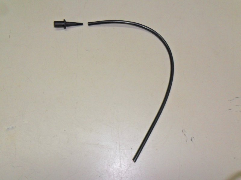

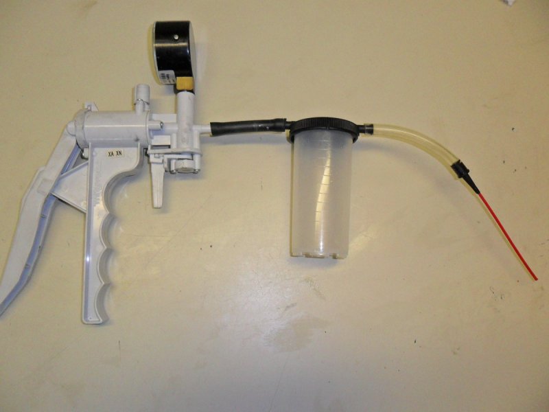

I share your concerns.  When I flush the brakes I use my vacuum pump that has a cup on it that will suck the fluid out of the reservoir.  I found it really hard to put a hose into the reservoir so I attach a small plastic tube like comes with WD40 to the end of the vacuum pump hose. That allows me to get most of the fluid out of the reservoir and refill with fresh fluid before I start flushing the brakes.  I may have a photo of my setup for doing that. If I can find it I will  post it.
Share this post

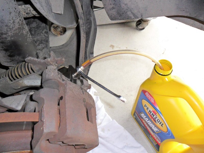

Here are a few photos that show how I do it.  That doesn't mean it's the best way but it works for me.

Ronnie......where did you get that black "adapter" that fits between the 1/4" tubing coming from your hand pump, and the small red WD40 tube?  If I cant find the same thing, I might just tape the red WD40 tube to the 1/4" tube.

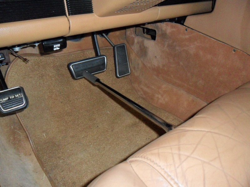

Also, did you put that "rod" between the brake pedal and the seat (and with it applying pressure on brake) during the rear brake bleed?  I guess this is to keep the pump running as you are bleeding the rear brakes?  Not necessary for the front brakes, right?

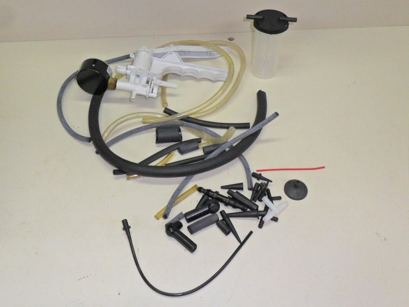

As you can see I have quite an assortment of adapters and short hoses for my vacuum pump. I believe that tapered adapter came with my vacuum pump.  it's made out of pliable rubber that allowed me to force the red wd40 tube inside it.  A small tube forced over the outside of it works equally well. That is what I used the last time I flushed my brakes. You can see it in the bottom photo below.
The rod is an 18" breaker bar that just happened to be handy.   I run the seat up against the end of it to keep the pump running when I open the rear bleeders to flush the rear brakes.  Anything of a similar length would work.  I still get my wife to pump the pedal when I bleed the front brakes.

OK.....18" breaker bar with seat pushed up against it to hold the brake pedal down....will keep that in mind when I do the flush/bleed on my 89.
