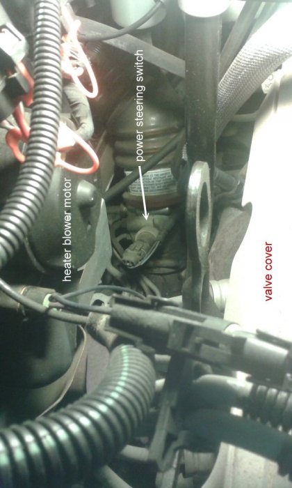

What I can't do is locate the power steering pressure switch but I've only tried to see it from the top.
You can see it from the top on the passenger side.

OK......Thank you for the photographs of the power steering switch. New low pressure switch not arrived yet.
