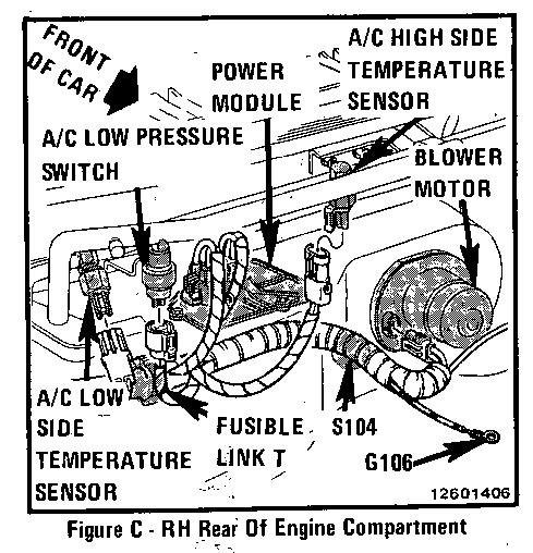

I would go ahead and change the Low Pressure Switch just to be on the safe side.  As Jon said, it is a relatively cheap part and you can do it yourself without losing hardly any Freon. No need to evacuate the system.  The fitting the switch screws onto has a schrader valve that will prevent much Freon from escaping.  If it's legal in  your country you  might want to get a Freon refill kit at the auto parts store and add some Freon yourself.  That's what I do.
Most any auto parts store will have it in stock (in the USA. don't know about England).  If you have any doubts about getting the correct part take you old one off and take it with you to the parts store.  This is what the switch looks like.  Some brands are black in color instead of silver. Sorry I don't know the part number but the parts store should find easily.

I remember my experience with the pressure and temperature switches on my '90 and they are not only a different style, they are also located differently than the posted diagram. The low Freon pressure switch is located approximately where the high side temperature switch is indicated in the diagram, and the high side temperature sensor is way over towards the drivers side. You may have the wrong sensor.

Hi, Yes I eventually found out that the low pressure switch on my car is further over to the driver's side.
Does anyone know the ACDelco part number? I've found out that the 15-5643 is incompatible with my car but the 15-2490 is compatible except for the fact that it is listed as the high side pressure cut out and not the low side. Very, very few switches listed as "low side".

Sorry that I mislead you on the location of the low pressure switch.  I didn't realize they had moved switches and sensors around on the '90 models. Thanks to 2seater for catching my mistake.  Did the compressor stay engaged when you jumped the correct switch?

Ronnie, I don't think you misled, locations don't match my FSM either. Just to be clear: the two temperature sensors are both located in the smaller diameter high pressure line, one near the turn into the evaporator immediately downstream of the orifice tube and the other, the high side temperature, is almost directly to the rear of the EGR valve. The single pressure switch is almost exactly centered between the two temp. switches and is located on the larger return or low pressure line.
