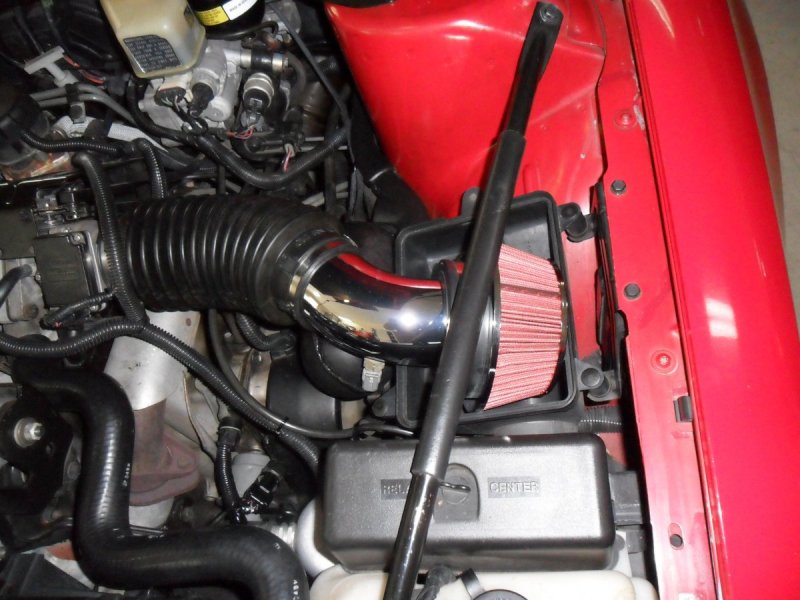

Ronnie Posted September 5, 2019 Share Posted September 5, 2019 I have a cold air intake for my car but I don't have it installed right now. I never got a code or a SES light because of it. . You can see the MAT sensor sticking out on the bottom of the chrome pipe in the photo below. I think as 2seaer said, checking for codes is the key to figuring out what is causing the problem. If the SES light is coming on it should set a code in history. Probably a code E023 (too cold) or E025. (too hot). I'm betting you have a code E023 because the FSM leads me to believe that would be the default code if you have a bad sensor or a bad connection in the wires going to it. Link to comment Share on other sites More sharing options...
