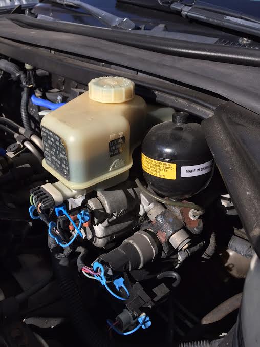

      I am bringing this thread back as I finally got my car home to complete this run of testing. I moved the first three accumulator observations to this post and added three others. Accumulator "D" is from my beater '89,  "E" is Ron's Hydac which is almost new on loan to me in transit to its new home and then "F" is my two year old Hydac. I added the number of "pumps" required for pump restart and the observed fluid drop for each accumulator.
Fluid capacity at various pressures                          pre-charge       Fluid drop   Pumps to restart   Working pressure fluid
A: 170ml @ 1500psi, 190 @ 2000 and 200 @ 2600      425#             .698"               1 pump                              10ml
B: 155ml @ 1500psi, 175 @ 2000 and 192 @ 2600      500#             .670"                1 pump                             17ml
C: 60ml  @ 1500psi, 102 @ 2000 and 135 @ 2600       1050#           .475"                2 +                                   33ml
D: 170ml @ 1500psi, 190 @ 2000 and 200 @ 2600      425#             .698"                1 pump                             10ml
E: 107ml @ 1500psi, 155 @ 2000 and 192 @ 2600       950#              N/A                 N/A                                  37ml
F: 107ml @ 1500psi, 155 @ 2000 and 193 @ 2600        925#            .682"                3 pump                             38ml
The observed fluid drop closely mimics the accumulator capacities noted in the pressure testing. While the Hydac units are larger, the two I have tested appear to have a somewhat lower gas pre-charge than a new standard style resulting in greater useful working fluid capacity, but not as much as indicated by the size. I have never been able to pass the "pump" test, so next on the agenda is a fluid change and all new flex brake hoses to see if that makes any difference.
